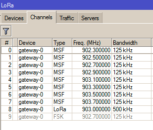

The correct channel plan was used?

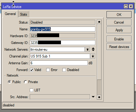

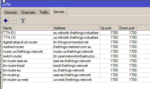

Did you add the server you are using to the lora device?
And did you enable the lora device?

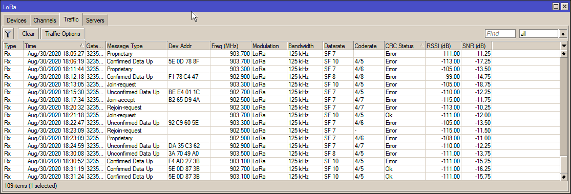

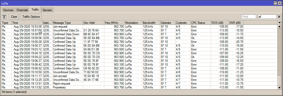

You can check inside the WAP LR9 config (http/winbox) if you are receiving LoRa packets and/or via log if your outgoing UDP to TTN is working.
LoRa > Traffic: Shows your incoming LoRa packets.
Log: lora-dl: [server_name] Keepalive timed out, could show a possible connection issue (for example)

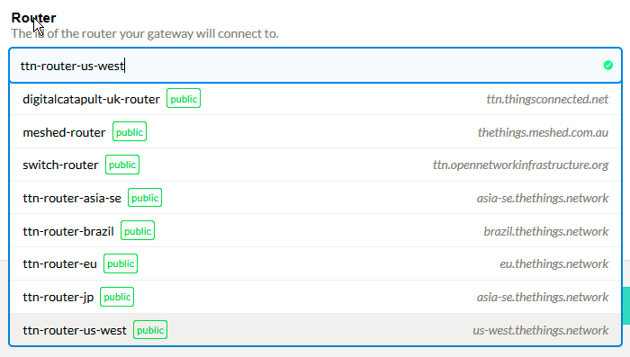

Hmm, maybe try:
a) an US TTN network server? You are using an EU TTN network server now.
b) check if your isp/modem/router doesn’t block the ports (udp 1700).
c) maybe read more info here: Mikrotik Gateway - Offline - not reconnecting
And try enable: Forward: Error for now, a lot more data gets forwarded then, to test.
Never ever forward error packets. That puts unnecessary load on the backend shared by the entire community.
It is not.
First change your network servers setting to ttn-router-us-west. Then read existing forum messages with regards to gateway status at the console and gateways (not) being displayed on maps. The short cut: the console status is not reliable and it takes time before a gateway shows on the map even when you have the privacy settings in the console set right.

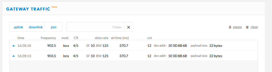

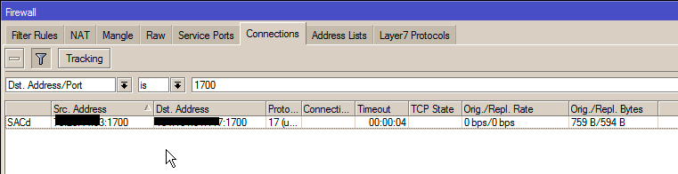

actually I setup my lora wap kit with external antenna 6.5 dB behind my mikrotik rb3011 and rules are ok … simulate with udp client/src … more below.
i did a lot of tests … same bug … but i give you more informations with pictures

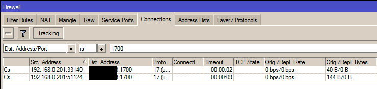

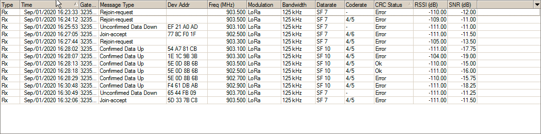

I want to know if my ISP denied udp 1700, so I used a udp client / srv between 2 computers from deferent ISP, no problem I can receive both side and I can a have a status with bytes
now time to use my udp software to capture the data from my mikrotik wap lora9 kit to my udp listener from another pc …
this the data from capture of lora kit
and I have from wire shark too :
{" stat":{“ackr”:0. 000000,“dwnb”:0, “rxfw”:0,“rxnb”: 1,“rxok”:0,"time ":“2020-08-30 19 :24:24 GMT”,“txn b”:0}}
some other error from my lora kit
I put the good srv (US) and put everything like doc from this site and still have the same bug
only one side data not bith side, I know is a forwarder but is it normal ?
what’s wrong ?? i dont know ??

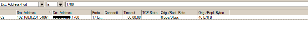

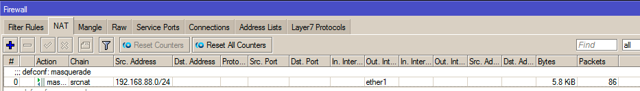

Judging by the connection flags I’d say you have a nat/routing problem.

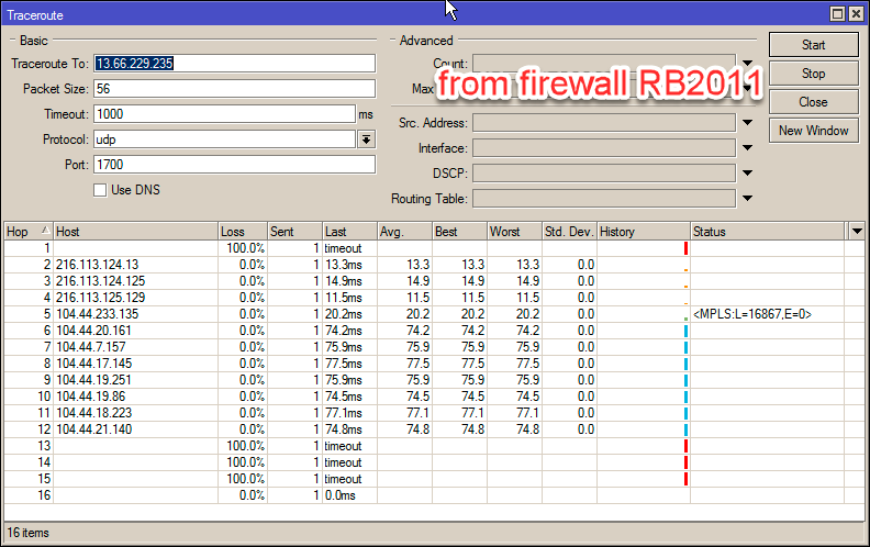

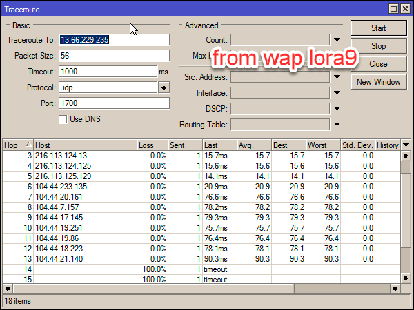

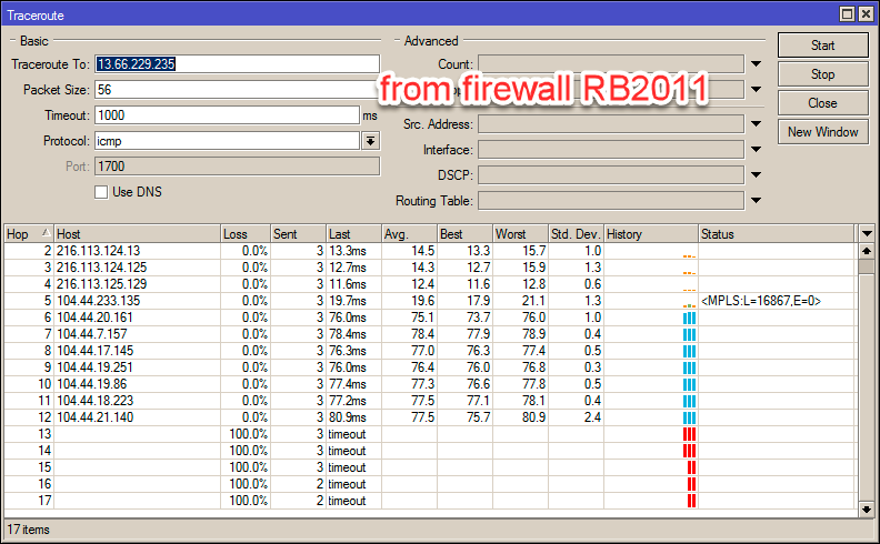

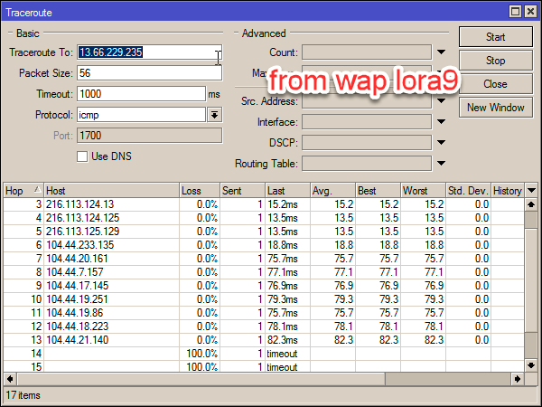

Can you use Tools > Traceroute and post a screenshot testing the TTN gateway you are using from the WAP and from the 3011??

Hi fcojmontilla,
I configure the new RB2011 for you, easier for me.
I hope thet info can help you, if you need more let me know,
I keep this setup intact for next tests
Thank you for your help

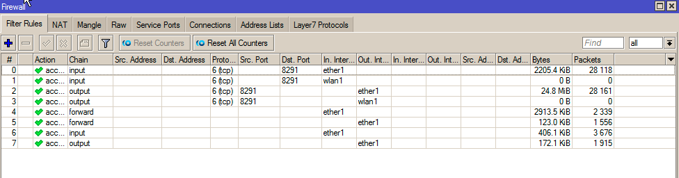

my setup :
mikrotik RB2011 firmware 6.47.2 (new from box and basic firewall rules !)
mikrotik wap lora9 kit firmware 6.47.2 (new from box and basic firewall rules)
servers=ttn-router-us-west
I can’t post my RB3011 in production security reason.
print screen :

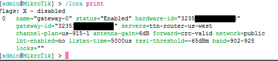

code from lora9:
Blockquote

/ip firewall filter
add action=accept chain=input comment=“broadcast off” dst-address-type=
broadcast
add action=accept chain=input dst-port=8291 in-interface=ether1 protocol=tcp
add action=accept chain=output out-interface=ether1 protocol=tcp src-port=
8291
add action=accept chain=input dst-port=8291 in-interface=wlan1 protocol=tcp
add action=accept chain=output out-interface=wlan1 protocol=tcp src-port=8291
add action=accept chain=forward in-interface=ether1
add action=accept chain=forward out-interface=ether1
add action=accept chain=input in-interface=ether1 log=yes log-prefix="IN - "
add action=accept chain=output log=yes log-prefix="OUT - " out-interface=
ether1

/lora
set 0 antenna-gain=6dB channel-plan=us-915-1 disabled=no forward=crc-valid

add action=accept chain=output dst-port=1700 log=yes log-prefix="udp OUT - "
out-interface=ether1 protocol=udp

Hi
now I’m connected ! wow ! maybe a ghost here :man_shrugging:
and status is green on web site !
I still have crc error , but the 2 lines OK is on the server
I will investigate …
That is nothing to worry about. It might be Lora, not LoRaWAN, transmissions or random noise received by the gateway. Every gateway receives packets with crc errors.
The important thing is to not forward those packets to TTN as that will only cause unnecessary load on the shared infrastructure.
HI again,
if I use router.us.thethings.network = 13.66.213.36 I have a udp feedback and everything is ok
but if I use ttn.router-us-west = 13.66.229.235 no udp feedback and no data, but thats the address from the console.
Why the address from console not working?
thank you
