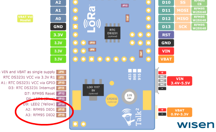

I’ve been playing with my Whisper Node this week and it seems to be working fine for raw LoRa (using RadioHead RF95 library), but when using the LMIC it sends only the first message to the LoRaWAN Gateway and kind of hangs after that.
I was wondering if that’s related to the RFM95 DIOs not being connected to the MCU? Here the documentation, looks like only the DIO0 is connected to the ATMega328p INT0, but the others RFM95 DIOs are not connected…
(source: https://bitbucket.org/talk2/whisper-node-avr-lora)
I’m about to solder a jumper there to connect the DIO1 (as far I understood I don’t need the DIO2), but would like to confirm with other users first as I’m not very good at soldering :thinking:

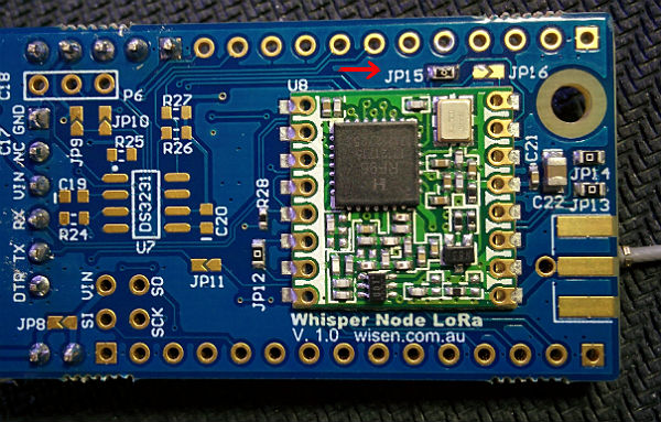

Just an update on this. I’ve manage to solder the jumper (JP15) and it worked! I need to confess was my first SMD soldering work and it wasn’t difficult at all.
Whisper Node with JP15, connecting the RFM95 DIO1 to the MCU A2
Here how my pin mapping looks like now:

Thank you @MoebiusL for sharing the required hardware change. This was my first SMD soldering too, but it was not too hard to do. As illustrated in your picture I took one of the Zero-ohm-links supplied with the nodes (a white strip of about 5) and soldered it over the two JP15 pads, functionally similar to a through-hole pin jumper.
I added a bit of flux on the two adjoining pads, heated them up with the soldering iron and lightly touched each of them with 0.3 mm flux cored solder, still applying heat. I carefully placed the small jumper over both of them using a pair of pincers and applied heat to solder it in place. As I did not have a suitable SMD tip for my iron, heat spread over both pads. Actually this helped in this case as the jumper settled quite nice. Finally I measured resistance over both adjoining pads to verify they were connected. I then changed the pin mapping for lmic.
My Whisper Nodes have been posting data to TTN for a few days now, and it seems to have resolved the issue in a reliable manner. I assume this was by design and part of the reason why the jumpers are supplied. So far I love these nodes and I think they are perfect for low energy applications.

(Bombix) #24
Soldering that small thing wasn’t easy, i ended up making a bridge with solder. (its the same thing i quess)
Clearly it made a diference since i see in the serial monitor the node trying to send something:
