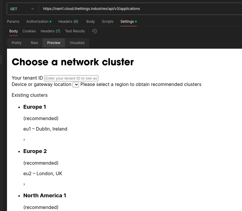

I may have missed a trick here. If you are on TTI, you should be using the TTI URLs prefixed with your tenant id.
So if I had a TTI instance in NAM1, the call would be to descartes.nam1.cloud.thethings.industries.
See Cloud Addresses | The Things Stack for LoRaWAN
This is using my personal API key with full rights granted.

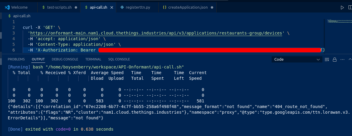

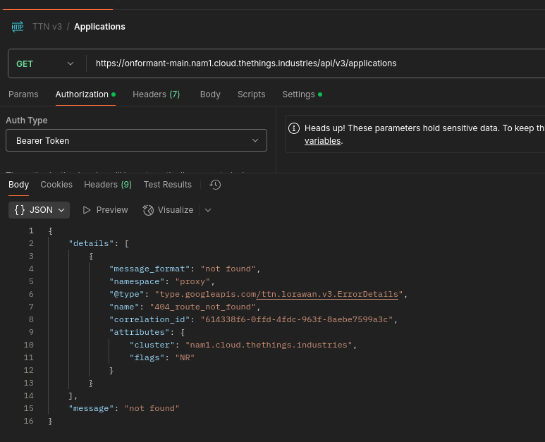

I also tried in VStudio for good measure:
This does all seem very strange - it’s not got as far as checking your API key as it’s not found the correct route.

Strangely enough I had it working even if my cluster is
foo.nam1.cloud.thethings.industries
by using
foo.eu1.cloud.thethings.industries
and its working fine, wondering if api DNS is in sync
