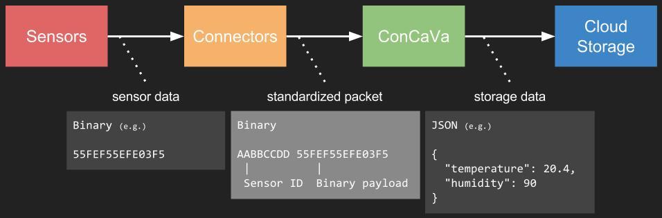

The design and configuration appears odd to me, I’d rather prefer that something deals with one and only one aspect. So a plain library and support tools. ConCaVa tries to solve too many things for my taste :wink:
