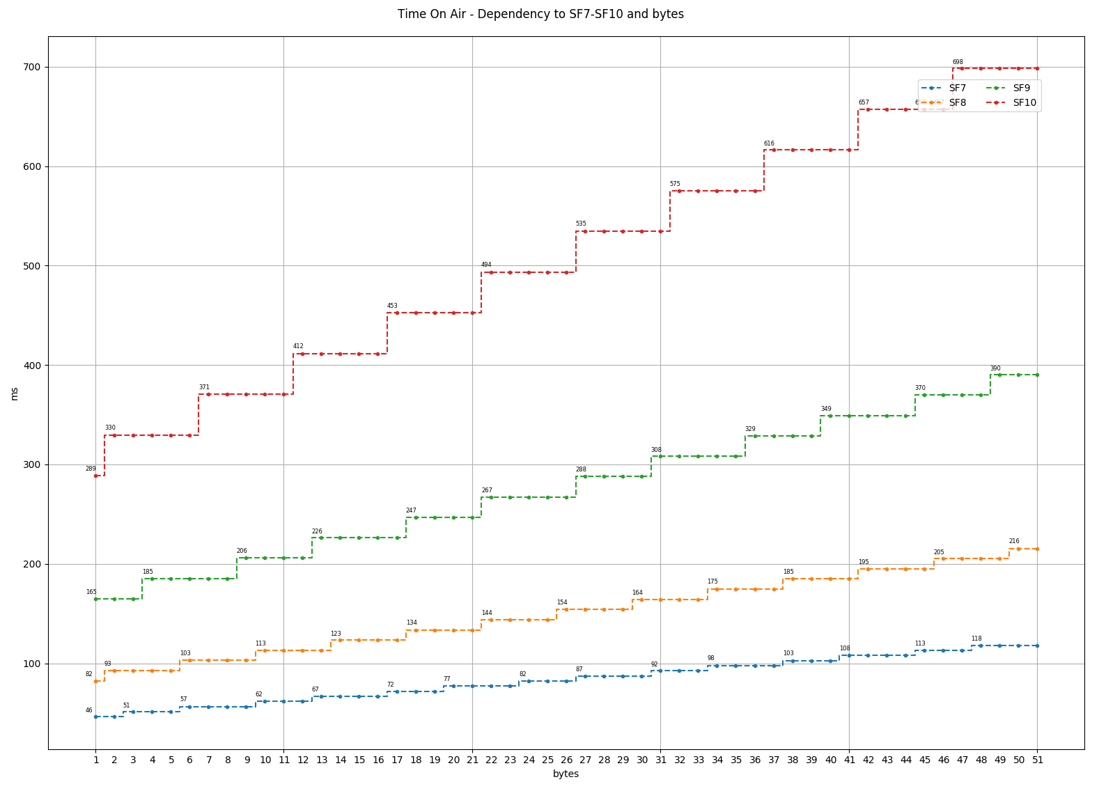

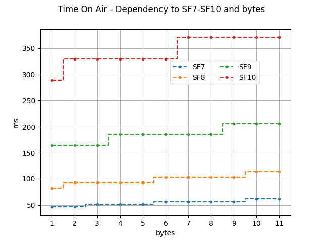

BTW maybe you like this graph, some days ago I realized with your calculator that the Time on Air is not linear with the bytes.
df-stack-ok-no-lables
bytes-vs-ToA-all-log
This is iirc an effect of the forward error correction. The time increments based on step increases in the coding block, just an extra bit/byte in payload forcing a new block even if not full up until just before the next step… TTN/TTI LoRaWAN uses 4/5 coding.

It is somehow explained in the paper from EPFL: the fixed-length blocks for LoRa is the combination of two things:
  • One LoRa symbol SFx carries x bits, and you are only sending full symbol.
  • The interleaving scheme used in combination with the FEC will force the number of LoRa Symbol to be a multiple of certain value (e.g. 5 for 4/5, 8 for 1/2)
Wow, Happy that I was inspiration for this graph - github
I made one more. Great for a poster :stuck_out_tongue:
