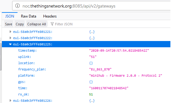

The noc appears to show it live:
However I note that the uplink count is quite low suggesting it has not been online for very long.

@pshemek do you see the number increase when you have the TTIG connected? See http://noc.thethingsnetwork.org:8085/api/v2/gateways/eui-58a0cbfffe801225 (Note that this is an HTTP URL; if your browser tries to use HTTPS then using an incognito window may help.)

@arjanvanb : once I connected the gw to internet and tested with my node, the packets arrived from my node to the application via the eui-58a0cbfffe801225 and my other gw 4 meters aside with basically the same rssi (55-60 dB)
