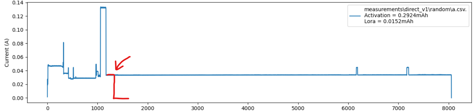

I am currently developing sensor nodes using LoRa class A to send the data. However, to reduce battery consumption on the arduino (Heltec ESP32 + LoRa v2.1), I wanted to know if it was possible not to listen for downlink messages after an uplink. Instead, I would like to immediately go back to deep sleep. Is it something that is possible?
The image below shows, in blue, the actual power consumption when sending and in red, what I would like to get (i.e. going back to sleep immediately)
Thanks in advance for your help !
That wouldn’t be LoRaWAN compliant and as neither the stack or you would be able to adjust any settings remotely, you aren’t going to see much enthusiasm for such a scheme.

The goal was just to be able to reduce the battery consumption even more (if possible). Now, you confirmed me it would not be LoRaWAN compliant. Thanks!
