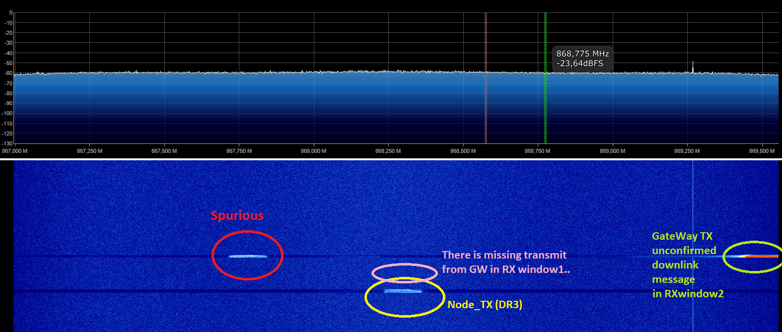

Dear,
I have node in Class C and Gateway
I disabled the ADR on my node.
When I set datarate DR5 - so uplnik work fine, but the downlink is not succesful.(even in one window).
When I set the DR3 - so uplink and downlink is succesful, but the downlink works only in RXwindow2. As you can see in the image - the GW does not transmitt at all in RXwindow1 - only in RXwindow2.
Sharp_traffic
Could you help me please where the problem is?
Thank you very much.
…Suppose that the the downlink data should be transmitted first in Rxwindow1 (independently on selected Class). Is not it?

So my assumption is correct, is not it?
As I know in classC after transmitting and closing RX1 window, node will leave RX2 open on default RX2 frequency.
So when you send to Class C you always send at defined RX2 freq…
