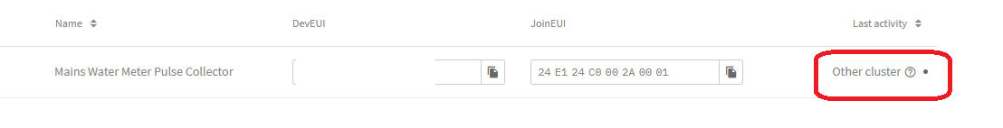

I was changing the settings in the network server address from our local server address to the things network address, the device has now greyed out and has the last activity as - Other Cluster.
I cannot open the device to make any changes. I would like to delete the device.
