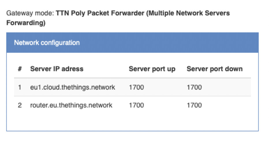

The first part was actually easy. Getting into the new console and setting up the gateway that I have here for V3 took less than 5 minutes. It is a Lorrier LR2. From there I could easily register a new gateway and insert the address eu1.cloud.thethings.network.
Succes. The gateway now forwards to both V2 and V3. I did however have to check in the slack community to know if I can actually get away with this or that I cause strange side effects. @jpmeijers was able to tell me that this is ok. This is not documented it seems so if anyone finds this thread: Yes it is ok to configure a poly packet forwarder to forward to both backends at the same time:

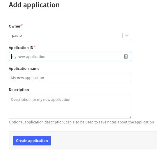

Click applications, and then
Now I’m slightly lost because what do I put here?

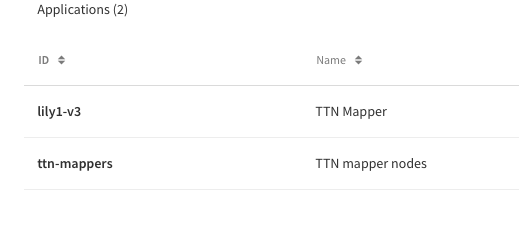

The docs didn’t really help me here so I just an Application ID that described my node “lily1-v3” and as Application name I choose “TTN Mapper” because that is what I want to do with it.
After pressing “Create application” I soon realised this was a mistake because in the next screen I should now add a node “Add end device” but I already named the Application ID with the name of my node.
No problem, just rename the Application ID, right? Not possible.
Go back, delete the application and just start a new one. Delete is not possiblele or I cannot find it. I guess this follows later.
Start again, create an application with an appropriate name “ttn-mappers”.

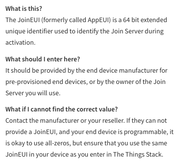

Now what? There is no button next to the JoinEUI so let’s look at the help pop-up/
Contact the manufacturer? No way, that cannot be the solution. Now what?

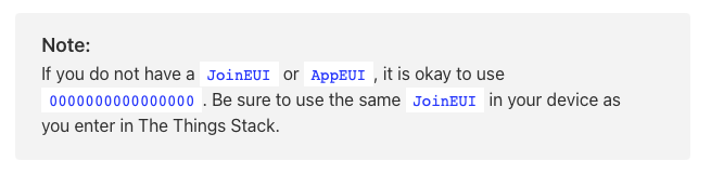

The docs have the solution:
In the section about OTAA scroll down a bit more and find this:
All zeros it is then.
Next hurdle, the DevEUI
No generate button. Help states: “Contact the manufacturer or reseller”.
I don’t think so.

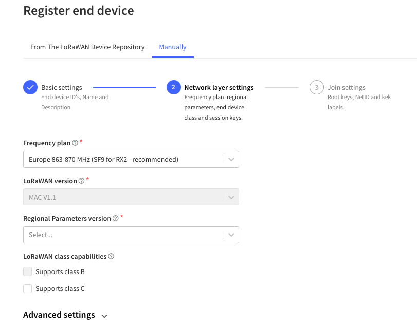

“Regional Parameters version”
No idea and “Contact the manufacturer”
I just choose PHY V1.1 REV B for no other reason than that it looks better than REV A to me.
LoRTaWAN capabilities class B seems ok to me.
