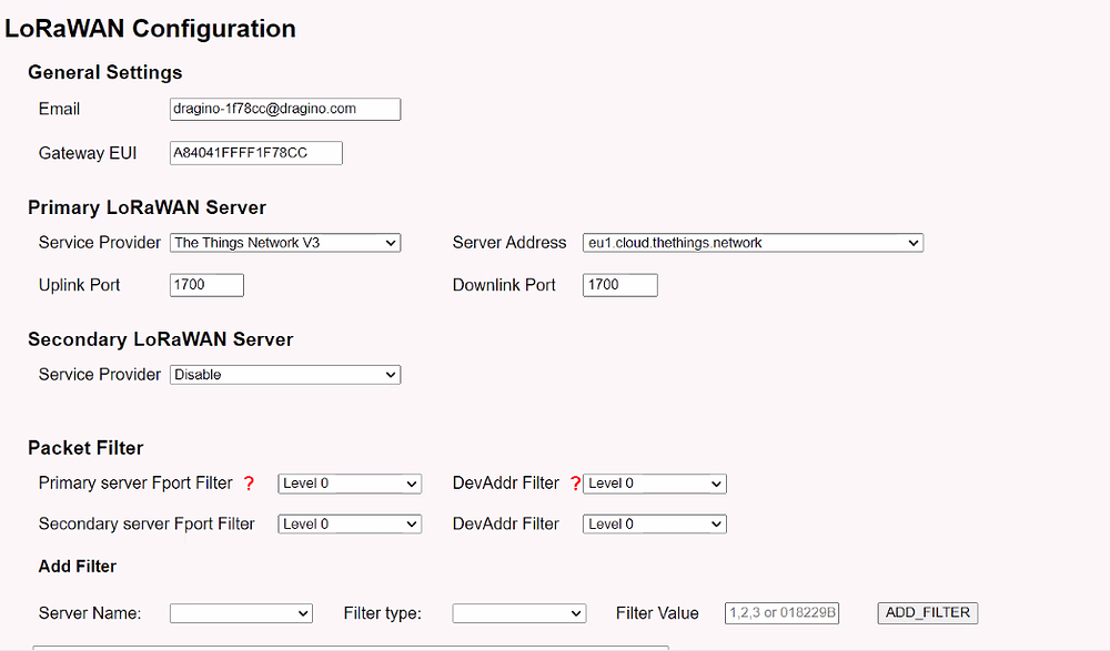

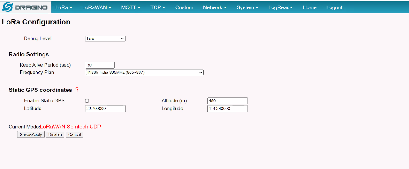

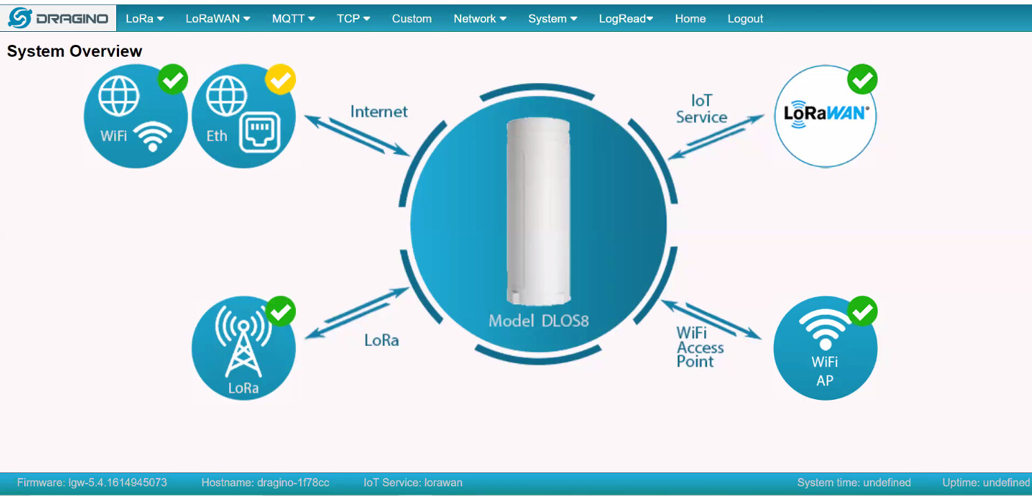

I am configuring dragino DLOS8 gateway and connect with TTN V3. I connect gateway to wifi and and configure to indian frequency. it shown status ok as below.

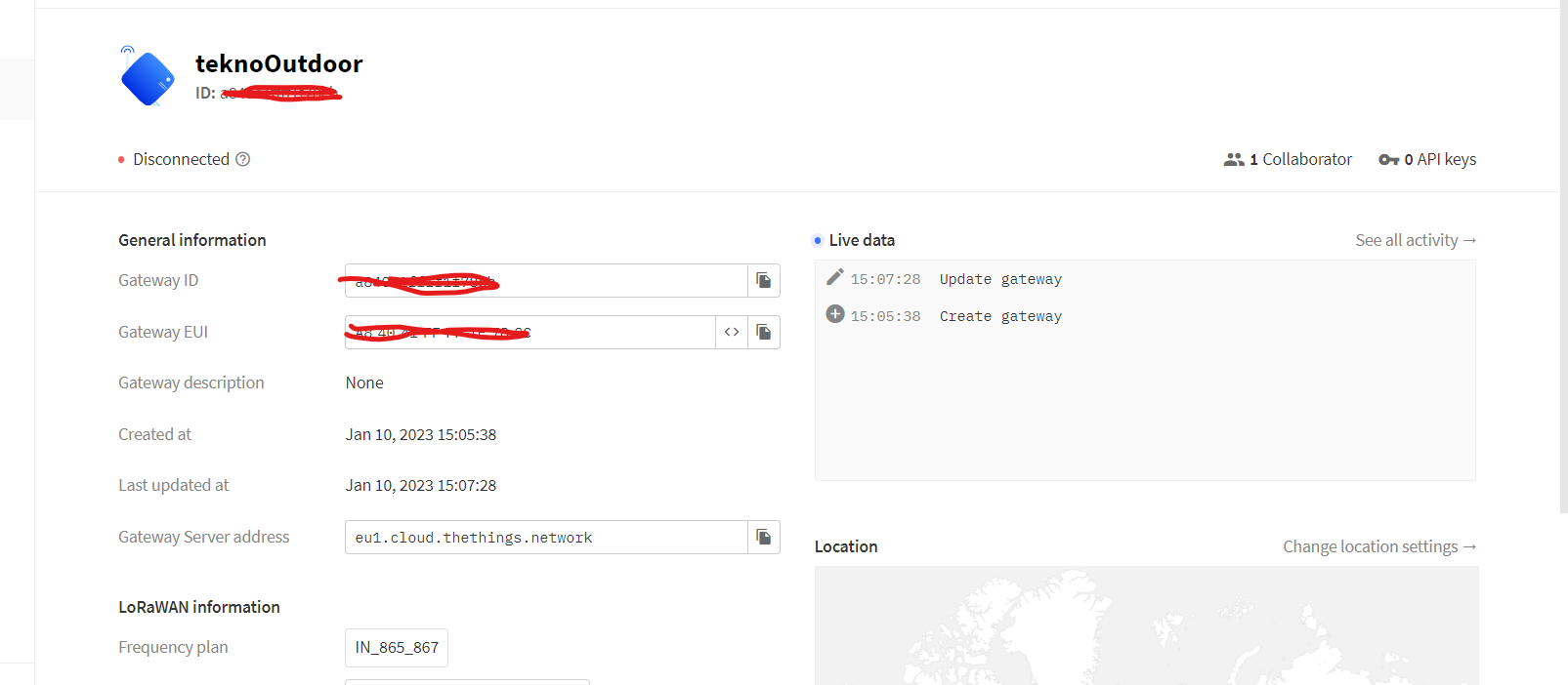

In TTN also I configure same setting in TTN also. but is shown not connected.
what I have to do now? I reset gateway also. Firmare upgrade also. please help me.
Which cluster is your gw pointing to?
I am using Europe cluster. and remaing indoor gateways work properly but this outdoor gateway not connected.

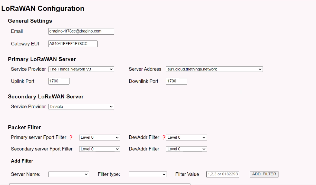

What packet forwarder are you using can you show Dragino settings…. Details please otherwise guess work for forum volunteers! :wink:
this are all setting

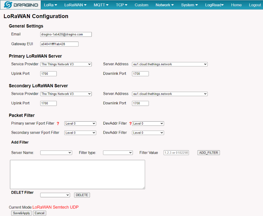

Hello there,
Not sure if this will help, but your config differs a little bit from that in the user manual:
Also it is always worth checking that you haven’t made a typo in the gateway EUI.
