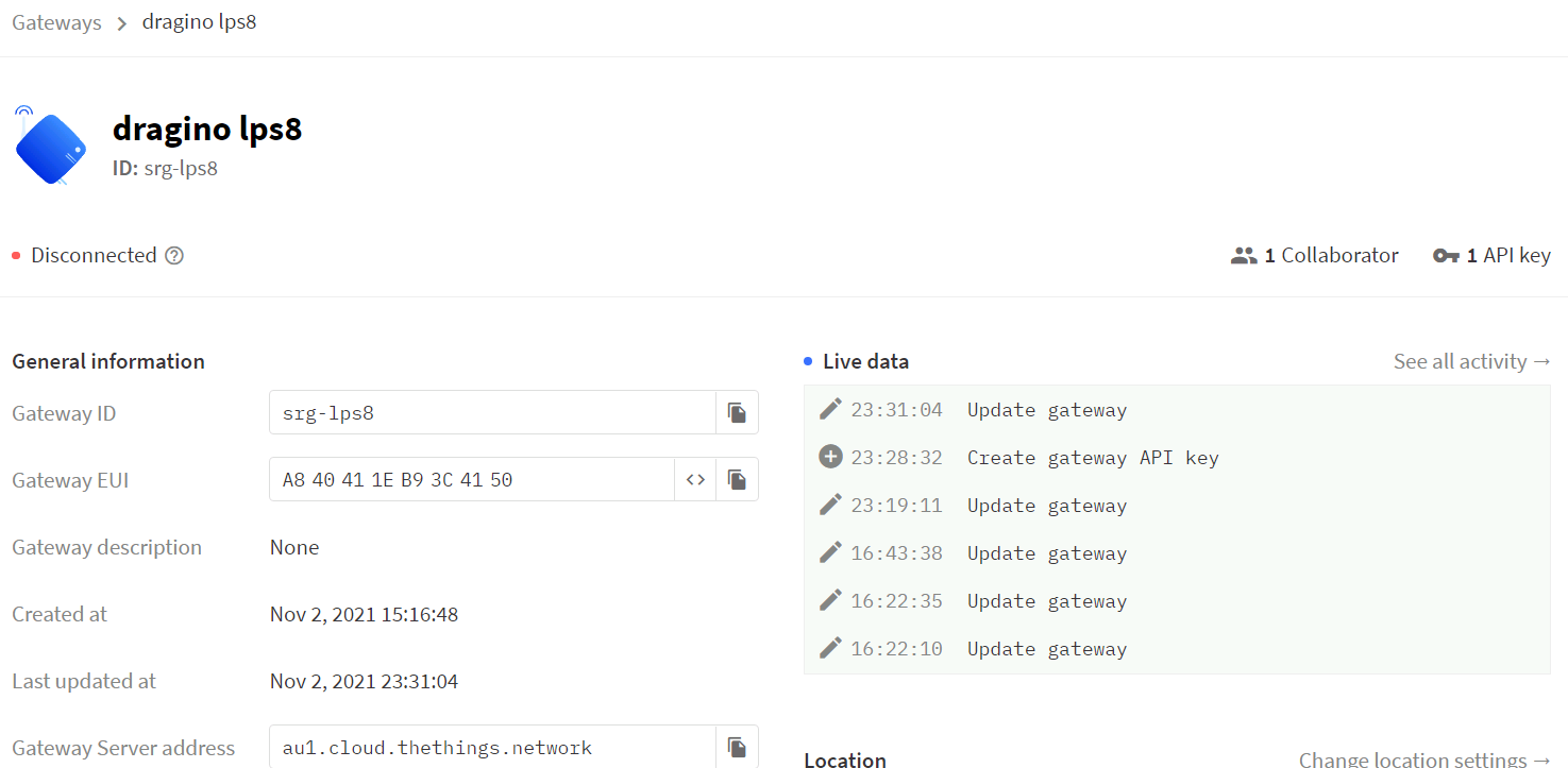

Do you see something in the V3-console Gateway Live Data?
Every 30 seconds there should be a message from your gateway concerning the gateway status.
If you use BasicsStation, the Gateway-traffic log stays empty for the firmware version beeing.
Hi Wolfgang, thanks - no there are no messages coming in, see screenshot :frowning:
