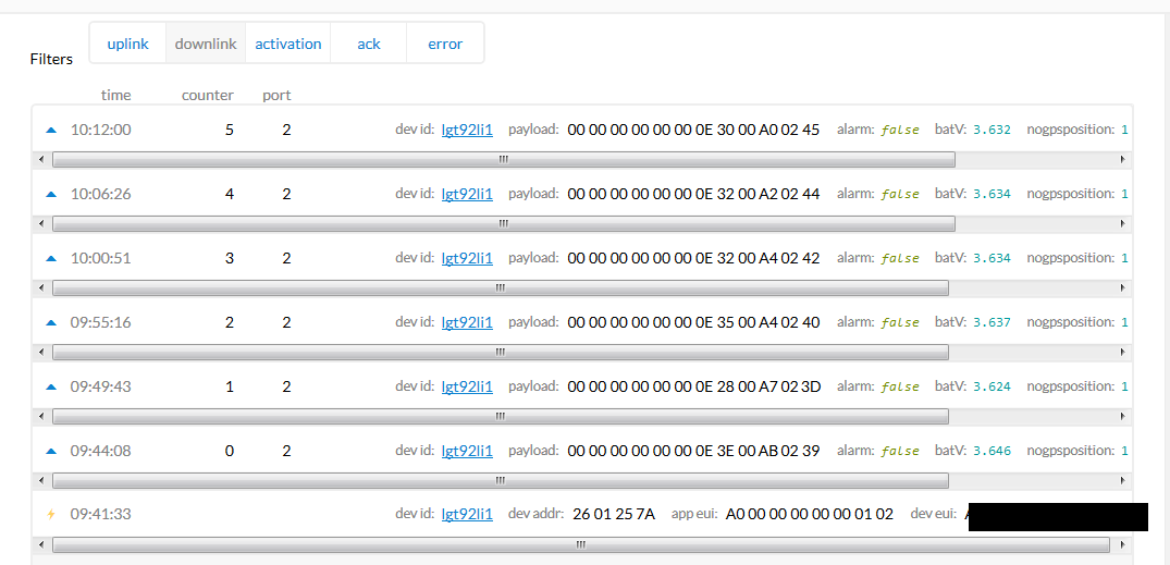

hi,
i connected my LGT-92 and was able to do a join: i have some connections and seen the location in the ttnmapper website.
however we are a few days further in time and tried to start the LGT-92 again:
i can see that it connects to ttn and the data is showing in the application however my location info is missing?
what are the regular times to expect a gps-lock for this device?
any tips how to fix?

I just received a new LGT-92. Stock Firmware
Connection by OTAA with my TTIG.
Put the node in the garden.
No GPS value!
WHY?
