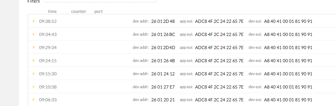

I can see this thing making join requests, but never being acknowledged and therefore not getting payloads from the device. What have I done wrong? Where to look? … other devices fine so not a gateway/network issue as far as I can tell … this is an OTAA join.

Thanks, yes - have all that. The issue is that it’s not completing the OTAA join – per the screenshot.
Note that clicking a Join Request in TTN Console will show you the details of all gateways that received the request, including their RSSI and SNR.
Thanks. As it happens there are a bunch of Gateways visible (mostly mine!) … Have not seen this particular problem, with other end nodes (and I have played with a lot of them now!)
