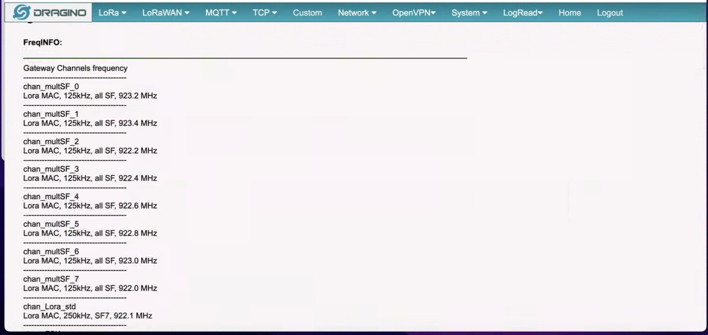

While troubleshooting, I checked the gateway logs (LogRead) and noticed that the gateway was operating on 923 MHz frequencies (AS923) instead of EU868.
Example observed frequencies:
**LogRead**
**FreqINFO:**
Gateway Channels frequency**
chan_multSF_0
Lora MAC, 125kHz, all SF, 923.2 MHz**
chan_multSF_1
Lora MAC, 125kHz, all SF, 923.4 MHz**
chan_multSF_2
Lora MAC, 125kHz, all SF, 922.2 MHz**
chan_multSF_3
Lora MAC, 125kHz, all SF, 922.4 MHz**
chan_multSF_4
Lora MAC, 125kHz, all SF, 922.6 MHz**
chan_multSF_5
Lora MAC, 125kHz, all SF, 922.8 MHz**
chan_multSF_6
Lora MAC, 125kHz, all SF, 923.0 MHz**
chan_multSF_7
Lora MAC, 125kHz, all SF, 922.0 MHz**
## **chan_Lora_std
Lora MAC, 250kHz, SF7, 922.1 MHz**
## **chan_FSK
FSK 50kbps, 921.8 MHz**

Despite selecting EU868 in the TTS console, LogRead consistently shows:
  • 923.2 MHz
  • 923.4 MHz
  • 922.2 MHz
  • 922.4 MHz
  • 922.6 MHz
  • … etc.
That means the gateway boots using AS923 defaults instead of the configured EU868 plan.

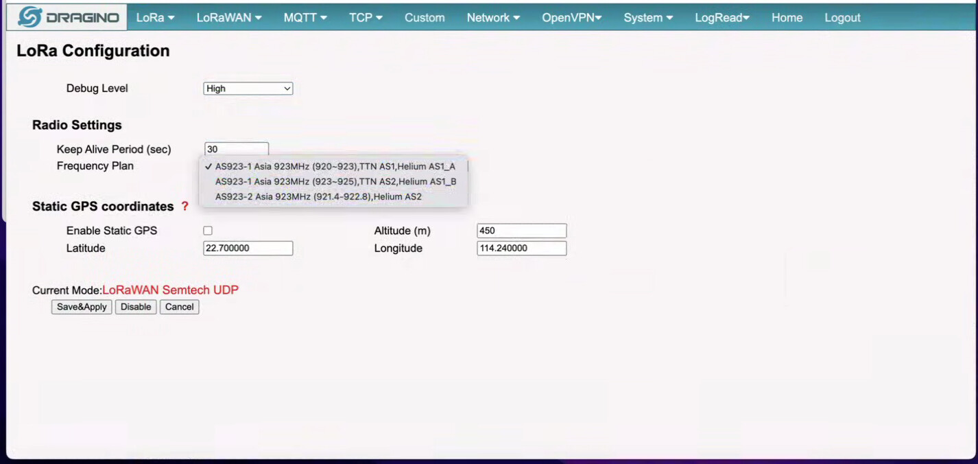

But it is not showing me the options for the reset of the frequencies and this is a very strange behaviour.
Because the Dragino DLSO8N is 868 supported but the web UI is not showing me the option to select this specific band
and also the LogRead are showing me the AS923 Band frequcies of receiver channels

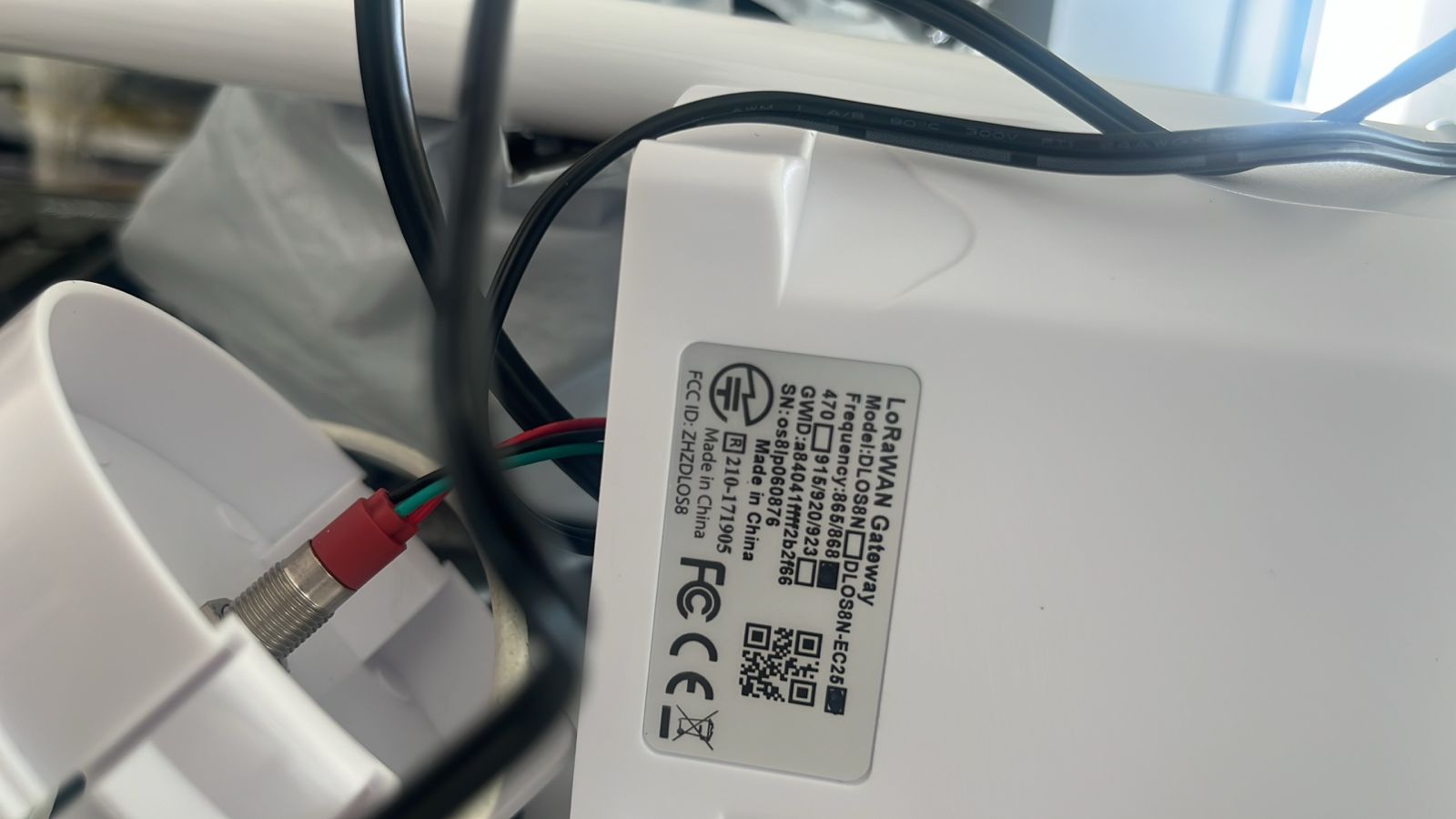

1st try to update the gw firmware version and see if you get EU868 option. If not contact Dragino support. Mispacked or misprogrammed SKU’s are not unheard of so label may not match actual shipped build. In early days of the TTIG I had a mispack where one of a half dozen ordered from a uk disty in single box had external labels saying EU868 but one proved to be a 915 on investigation. Had same problem of devices not being heard…..opening up confirmed a config smt resistor on pcb in 915 vs 868 config position……just got seller to replace.
Update: I notice you have the -EC25 variant with embedded Quectel EC25 cellular modem. Which version did you order? What was shipped (invoice/dispatch/shipper docs, box, inners etc.) There seems to be atleast three variants with just the Freq marking block to discriminate on the GW case label so scope for error:
Regional Variants: The EC25 version is available in multiple regional configurations to match local cellular frequencies:
  • EC25-E: Standard for Europe.
  • EC25-AFX: Optimized for North American carriers.
  • EC25-AUX: Optimized for regions like Latin America and Australia.
Looks like the E vs AFX vs AUX isnt called out directly on the device?
Your DLOS8N is coming with AS923 firmware. You might need to replace it with international firmware. Download at click. After flashing the new firmware you will have more freq options.
I know several/many of these were shipped with the wrong firmware in the last few months - I got 2 of them that had ‘Thai-5.4.1713921192’ installed. I installed to lgw-5.4.1753346938 to get access the EU frequencies.

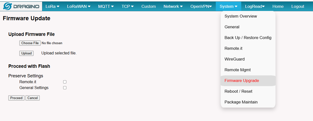

The firmware upgrade was quite difficult to do I recall but can’t remember why right now.
Contact your supplier?
Firmware upgrade can be done by using Web Admin interface (System/Firmware Upgrade)
