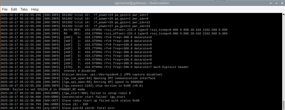

Please my gateway connects to TTI (LNS mode) but fails to start the radio. as shown below.
I also tried the following to fix it but still running into the same errors:
SPI is enabled on the Pi; /dev/spidev0.0 and /dev/spidev0.1 exist.
GPIO17 is used for RESET, GPIO18 is held HIGH as POWER_EN using gpioset
RESET_GPIO=0 is disabled inside the container (I perform resets manually).
The BasicStation container runs with privileged: true and has /dev/spidev0.1 mounted.
Frequency plan set to EU433 on TTI. beacuse am using RAK5146 433-435MHz
I’ve tried both SPI_DEVICE=/dev/spidev0.0 and /dev/spidev0.1; both yield chip version 0x00.
the docker-compose.yml file is shown below as well:

Please do not hijack random threads.
If you are using a well documented product like a RAK concentrator card, what does the docs say?
As RAK provide installers, do they work?
