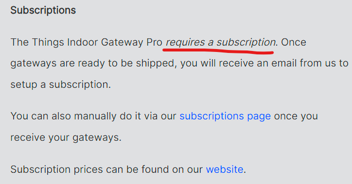

(for @siva96 as well): yes mine is a The Things Indoor Gateway Pro, no doubt about it, a disc with two antennas.
But, when I bought it, which was the 3rd of October it was NOT clear to me that a subscription was required. And I just checked with the Internet Archive and back then it did NOT mention that a subscription would be required!
I have no need for cellular access (for now) so I’d like to use the gateway free of charge (for now). Is that not possible?
If not I would most likely not have purchased this gateway. (I bought it because I wanted the latest hardware, for no other reason really)
Somewhat confusing that you put in a screen shot that shows that a subscription is required - where is this screen shot that you have provided from? It would help you more if you showed the Internet Archive page and the URL you are referencing.

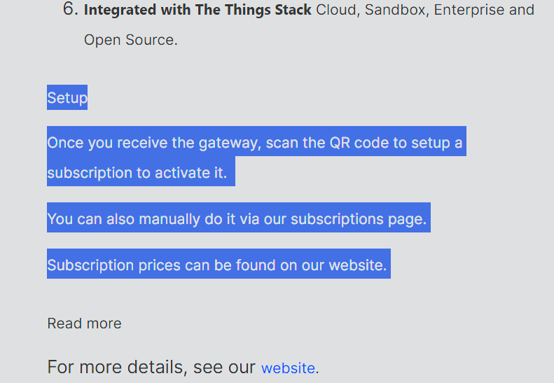

Well, it doesn’t say it’s required, does it? You might argue that’s it’s implied somehow by the wording, but it definitely wasn’t clear, which is probably why they changed it because this it what it says right now:
And the URL is simply the product page one: The Things Indoor Gateway Pro – The Things Industries pasted into the Internet Archive.

I assume the first image is what you see on the Internet Archive.
And the second image is what you see now.

TTIG Pro requires a subscription to work. This is both on the website and on the gateway purchase page.
The previous description on the purchase page clearly says “setup a subscription to activate it” but we can totally understand as a consumer how it can be missed.
We have indeed changed the description to make it explicit that the gateway requires a subscription.
For your current case, you’ve raised a support ticket with us so let’s discuss options there.
