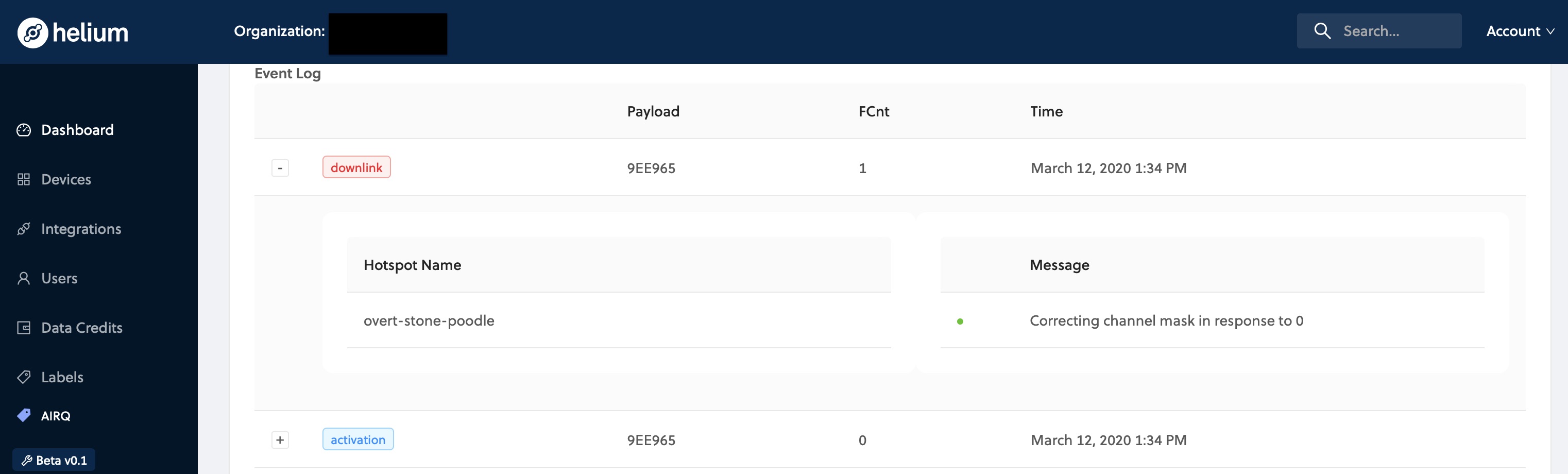

I’ve retrofitted one of our EU868 gateways (our solar powered system using RAK7294) to Helium, it’s quite simple really - for now just needed a mapping of EU to US frequencies and data rates. I can post the miner code which does the mapping if anyone is interested - or just wait for official support in about 2 months’
Screenshot 2020-03-12 at 13.44.19
I am interested, thank you.

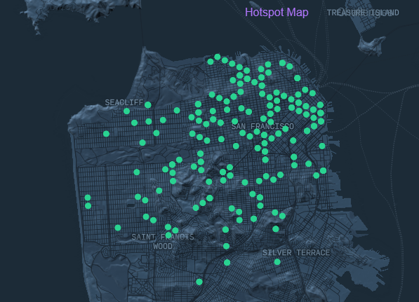

@illperipherals I do agree on the incentive piece, at $350 a pop, SF is totally covered while there are only 2-3 working TTN gateways even a Raspi gateway is less than half that of the Helium hot spot. Something must be compelling people to buy into it :slight_smile:
