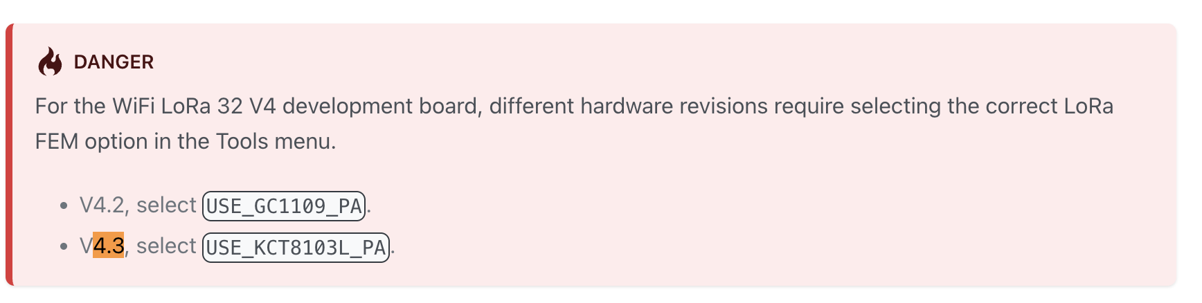

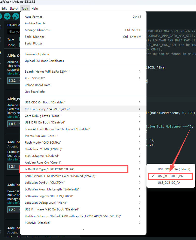

I managed to reach TTN! Once it was clear the issue was with the board, I emailed Heltec’s support, and all it took to make their library work was to set the correct flag:
If your board is V4.3, you need to select the KCT8103 option in the Tools menu. After that, the LoRaWAN examples included will work properly.
