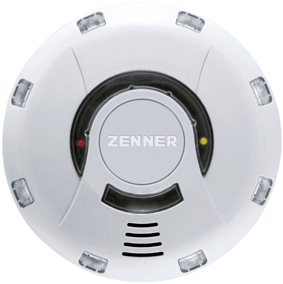

After turning the device on it should register. I entered only the LoRaDevEU at the TTN console. But the smoke detector does not connect and I don’t see any packets in my gateway (edit start) when I look to the TTN console (edit end).
I have read your article about the smoke detector and tried to contact you via the TTN web contact page which did not work. I hoped you would know how to set up the device with TTN.
Now I’m glad you’re are reading my post here but from your first response I assume the the keys I got are for the Zenner platform and I need to talk directly to Zenner to find out how to register the detector with TTN.

The device is sitting right next to my TTN gateway and a ZENNER gateway is about 25 km far away.
Furthermore, at the first power on of the device it tries for a period of 20 mins to join a network which is indicated by a yellow blinking LED. After 20 mins the LED went off and from now on the device tries every day one time at a random time to connect via OTAA .
Therefore I assume that it is very unlikely that it could have reached the ZENNER gateway.

In the meantime I had success. To be honest, I am still figuring out why.
Even though my self build gateway with a Raspberry Pi and a Sandbox Electronics LoRaGo PORT did receive packets from other devices, it did not receive the smoke detector. After I have given the smoke detector to a friend with a gateway from Laird it showed suddenly up.
In the next days I will get the smoke detector back and will test if there is a problem with my gateway.
