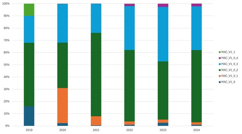

This graph below is something I got from a LoRa Alliance presentation a year and a month ago. I bet that v1.0.4 has seen a decent gain last year but I don’t have something more recent.

Does this graph depict the worldwide deployment of end-devices or is it from a specific company? You can provide the name of the document so I can read it (I have access to the LoRa Alliance intranet).
I tried to find the document but could only find the screenshot I took. This graph was based on numbers provided by some of the largest providers (IIRC from Actility, Swisscom, Loriot, TTI and I believe one or two more).
The screenshots were taken on 14-06-2025 if that helps.
what is missing in the chart is the total sum of devices per year. since runtime of a node is up to 10 years i dont think the total amount of v1.0 decreased that much the chat suggests. just the total amount of nodes increases.
