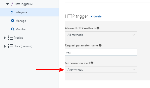

Next step is creating Azure Function App as HTTP trigger function. For now, I left my function app unsecure (anonymous). This is first step, checking basic functionality…Next step is making all secure with keys… :slight_smile:

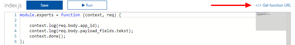

  • Here is code for Azure function:
    module.exports = function (context, req) {
      context.log(req.body.app_id);
      context.log(req.body.payload_fields.tekst);
      context.done();
  • Set Azure function for anonymous access
  • Get URL for Azure function and save it somewhere

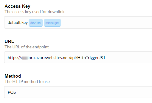

HTTP integration for TTN application
  • Put Azure Function URL in URL field for TTN HTTP integration
If you are lucky, you will see news in Log window of Azure function:
