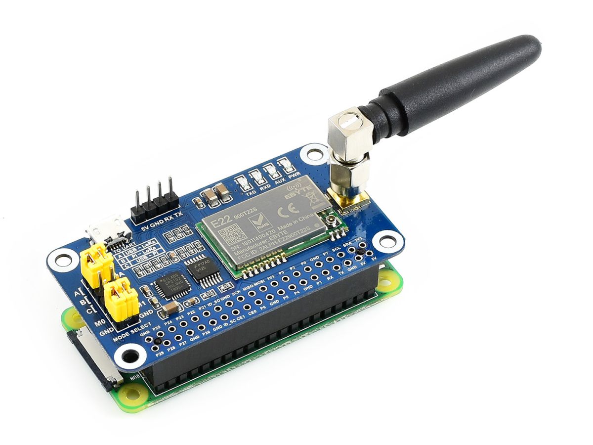

You do not provide a link to the Waveshare product you have to hand but assuming it is this one
Documented here
You will note it is clearly called out as a LoRa HAT NOT a LoRaWAN HAT, and indeed in the device introduction it states:
“This product uses a private protocol and does not support LoRaWAN.”
