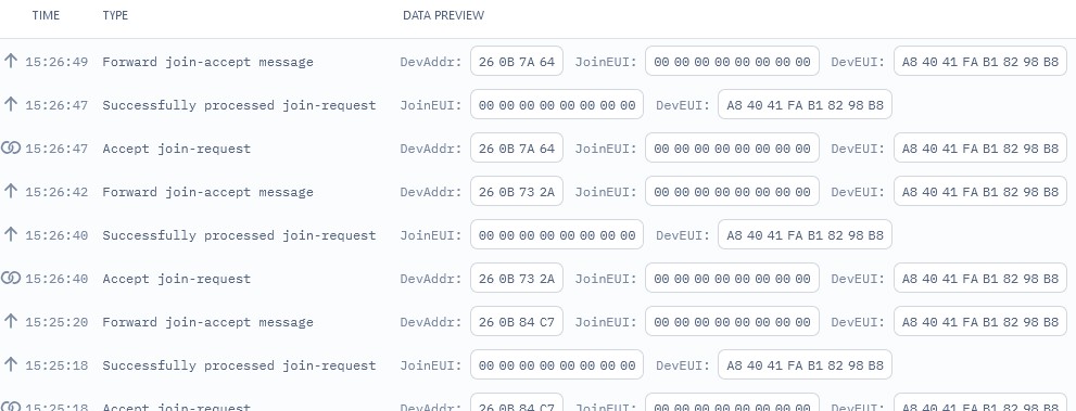

Both devices keep sending join requests which are approved:
Screenshot 2024-12-07 152705
But they never receive the answer. This is what the console on the devices keeps saying:

Join Accept is accepted, all good.
