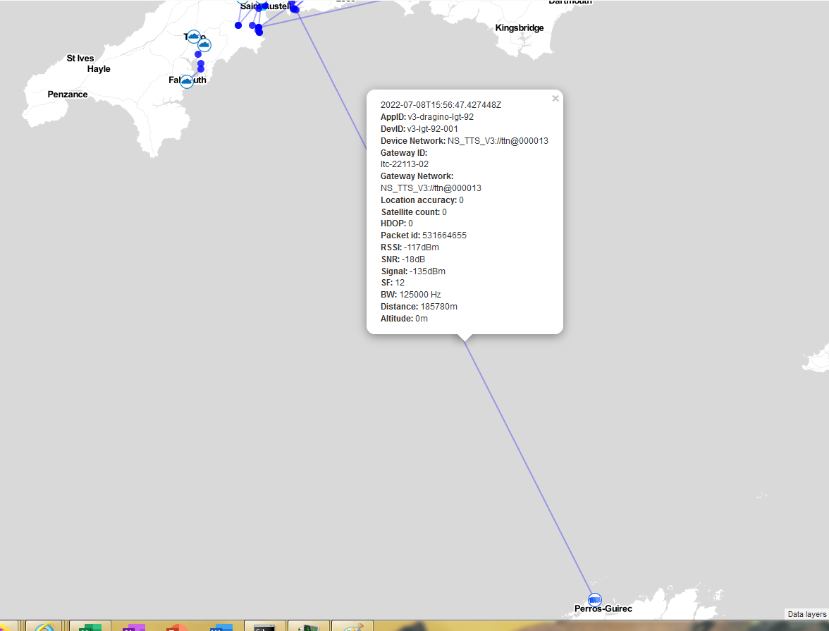

Indeed, I’m currently using a bunch of LoRa Motes & Trackers for mapping parts of Cornwall UK and looking at results tonight I see yesterday afternoon one of my LGT92 of a similar build/vintage (I need to check exact firmware version - might be 1.40 or 1.43) managed to ping a GW in Poulmanac’h on the north coast of France near Perros-Guirec from St Catherine’s Fort near Fowey at the mouth of the estuary in Cornwall… a distance of ~186km - a new record for me and for that device, on TTN(CE), with data captured in Cayenne Dashboard and logged on TTNMapper using the appropriate TTN Integrations

Nice! I already had point the other way (GW in UK, device in Brittany), but it depends on the weather…
