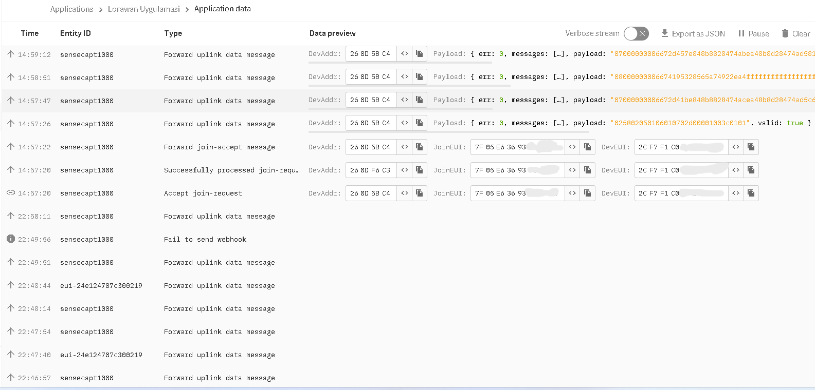

I am using a Milesight Gateway UG63-868M model gateway. I can receive data from the sensors and send it to my own application successfully. However, approximately 1 day later, the live data connection from the gateway stops, and I do not see any data on the live data screen until I restart the gateway. Once I restart it, the issue is resolved, and live data can be received correctly again. I’m seeking assistance on what the problem might be. Thank you.

First of all, thank you for your responses. Actually, I am new to LoRaWAN and I am trying to learn how to read data from some sensors I have acquired and use this data in my projects. What I am trying to do is to be able to receive emergency notification messages through monitoring and tracking in an indoor environment. For this, I am setting up my own LoRa network to be able to read data from some tracking sensors (like the SenseCAP T1000). I am trying to understand whether LoRa networks are suitable for such projects. I think I am hitting the fair usage policy. The reason for the high incoming signals is that the sensors and the gateway are very close to each other. Thank you for helping me understand the LoRaWAN technology.
