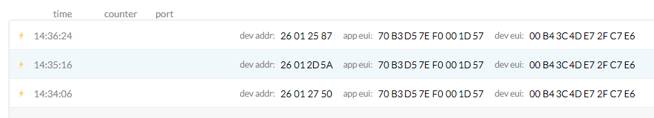

I do see data coming in on the console every 60 secs but it has a different dev addr each time.
(looks like it keeps trying to register again and again?)

In console:

Ah, only now I see that the screenshot from TTN Console are not the incoming uplinks, but the outgoing OTAA Join Accepts. Apparently TTN is accepting the secrets in the Join Request (so that’s good) but your node is not getting the Join Accept, so this is false:
Make sure your gateway is sending the Join Accept, and see LMIC_setClockError.

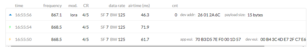

PS. How can I check if my gateway send the join accept? I checked the traffic tab in the console but not seeing any data
Make sure your have that page open before the Join Accept is sent. It might also go out through another gateway, if the Join Request was received by multiple gateways. See screenshots in Things Uno not joining anymore - #5 by arjanvanb.
I checked the gateway used in the package data so I knew it was using my own gateway.
But having the page open when joining works:
thx a lot!!!
