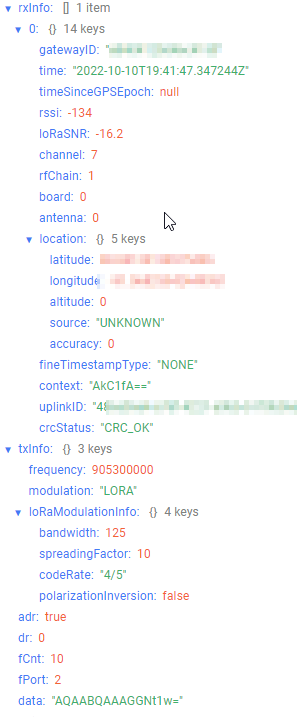

At such short distances RSSI of -123 to -135 you 99% chance you antennas are not working.

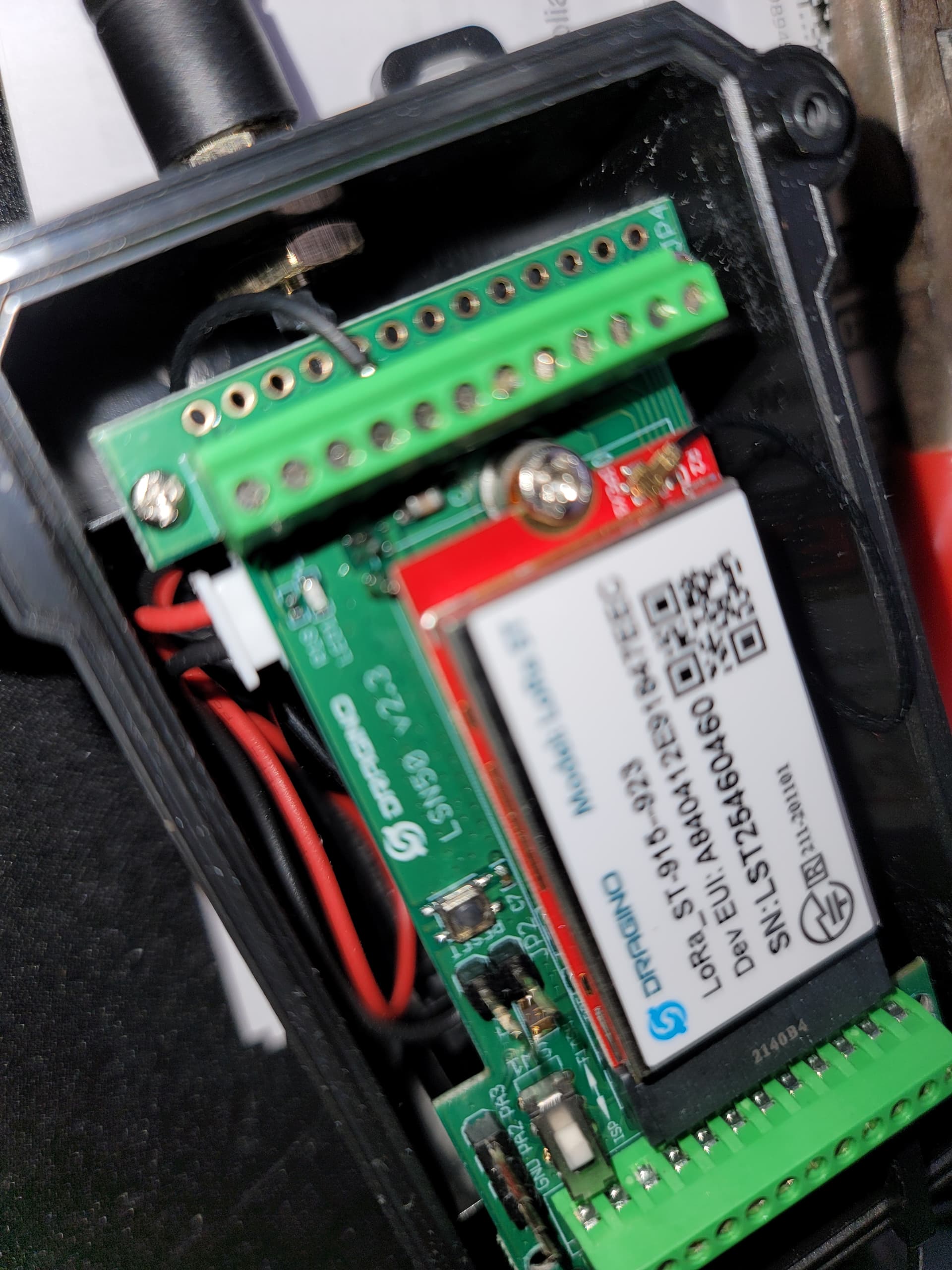

@Johan_Scheepers - I agree - I’ll check them again - on the LPS8 - the female has a smaller end on one side which I believe goes into the unit and then the outside is more normal shaped which the antenna should go on I believe. I made sure both ends are tight. On the LDS03A - there is a black wire with a button like cap for the antenna that is attached to the board - but I can not tried removing/reseating it - I’ll try that now.
Have you ever run your GW without antenna connected? Dont be tempted, and if doing these changes and checks power off before disconnecting ant…otherwise… :frowning:
Sounds like uFL connection - dont remove and just press to check on securely…

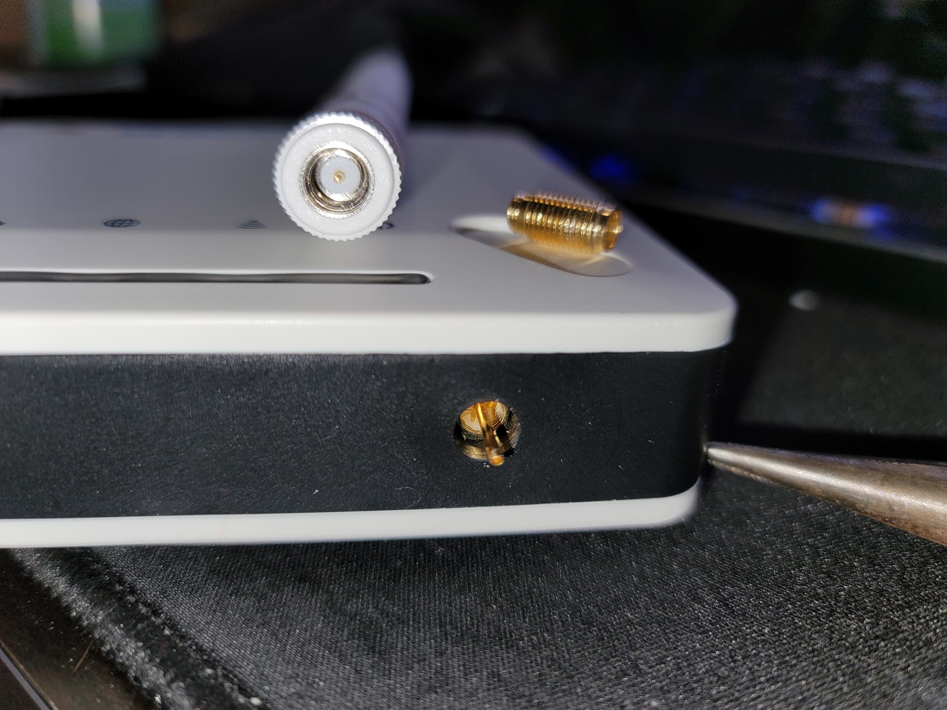

That threaded barrel should not actually come out.
There are normally a piece of plastic ensuring the center pin don’t troche the outside. When you reassemble you need to take care of this.
Make sure it goes in all the way and the two center conductors make good contact.
Thake note on how Jeff pic look like
It came out when I removed the antenna this morning checking to make sure it was tight - so I put it back…I thought it was odd too. I’m not sure, other than it’s not bent, how to keep it from touching the side. But I understand what you’re saying
@Johan_Scheepers
got it - there is a little white disk on each side (LPS8 AND THE 915 ANTENNA) - confirmed.
Take note of the locking nut as well, it is there to secure the connector on the gateway side, so it does not come apparat.
No locking nut on this unit. :confused:

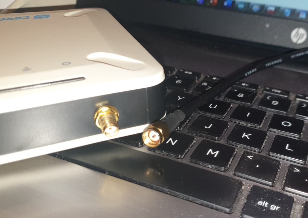

Difficut to tell - need a slight side view on that antenna connection - but looks like if/when you can re-assemble the SMA barrel connector (carefully!) you have a female to female problem… I take it you bought the ant seperate from the actual GW? (They usually come with a suitable ant - often a rightangled SMA so ant vertical when GW flat) You might also try to source a male to male adapter to connect the two.
