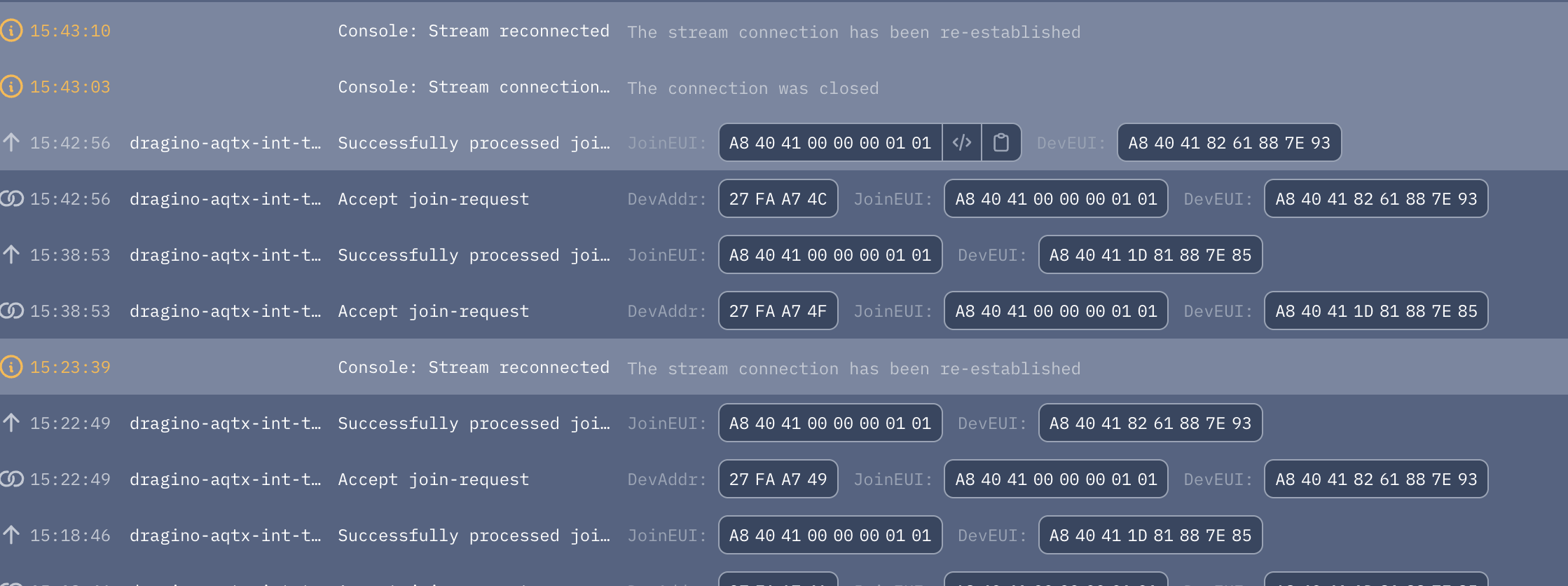

I’ve moved three of my devices over (waiting to move Gateways at a later date), and i’m getting join requests successfully to my devices on the Cloud version (screenshot attached). However, the devices don’t ever seem to receive any data. The uplinks are still happening on their regular cadence, but they’re just the join attempts.
Any thoughts on what’s going on here?

My guess is that downlink scheduling has been disabled for this device. If so, the Network Server never transmits the join-accept, which would explain why every uplink is another join attempt.
Could you check it with the CLI?
Step 1: Configure the Things Stack CLI to talk to your Cloud tenant — see Configuring the CLI.
Step 2: Log in with the CLI to your tenant.
Step 3: Read the current value:
ttn-lw-cli dev get --application-id <application-id> --device-id <device-id> --mac-settings.schedule-downlinks
Step 4: If it comes back false, enable it:
ttn-lw-cli dev set --application-id <application-id> --device-id <device-id> --mac-settings.schedule-downlinks=true
