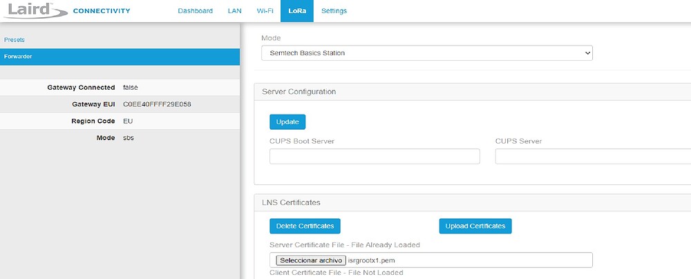

) which instructions did you follow to register and if needed update gw?
In the sentrius RG-186 → LoRa → Select Preset = The Things Legacy - EU
In the sentrius RG-186 → LoRa → forwarder → Mode = Semtech Basics Station
In the sentrius RG-186 → LoRa → forwarder → LNS Server = wss://eu1.cloud.thethings.network:8887
In the sentrius RG-186 → LoRa → forwarder → LNS Certificates → Server Certificate File = isrgrootx1.pem
In the sentrius RG-186 → LoRa → forwarder → LNS Certificates → Key File = tc.Key

What does gw local dashboard show?
Sin tĂ­tulo

Hi bwooce,
I check the log files how you told me and a can see this:
[AIO:ERRO] Malformed URI - expecting ws(s)://host:port (no path, port mandatory) but found:wss://eu1.cloud.thethings.network:8887/
/opt/lora/basicstation/tc.uri: Misconfigured URI - expecting scheme ws: wss://eu1.cloud.thethings.network:8887/
No server URIs configured - expecting at least one of the following files to exist:
/opt/lora/basicstation/tc-boot.uri
/opt/lora/basicstation/tc-bak.uri
/opt/lora/basicstation/cups-boot.uri
/opt/lora/basicstation/cups-bak.uri
/opt/lora/basicstation/cups.uri
i think that LNS Server is ok, i have put wss://eu1.cloud.thethings.network:8887/

i have remove de / that there was after 8887 and now i do not have this error, but the GateWay Connected still is false
i do not what happen

Hi everyone I hope you are doing well, I am trying to connect my Laird gateway to the TTN but it seems that I do not have the right firmware version. So please can you check it with me. If I need to update the firmware which link I can use I found a lot. Thanks a bunch.
It loooks like you are targeting the old V2 instance of TTN - wrong server - no longer operational. No doubt due to selecting a preset in the LoRa TAB which, depending on revision/age of f/w will still have old defaults.
Manually go in and simply change server to eu1.cloud.thethings.network, keep port 1700 and change Packet Forwarder to Semtech legacy if not already set for that - ignore any calling out TTN. Should then be golden. You could update f/w if needed and go the BasicStation route but a bit more complex and whilst more ‘secure’ I find my old Lairds are working fine on V3 with UDP with no issues and no significant packet loss to date.
Thanks a bunch, much appreciated :smiley:
