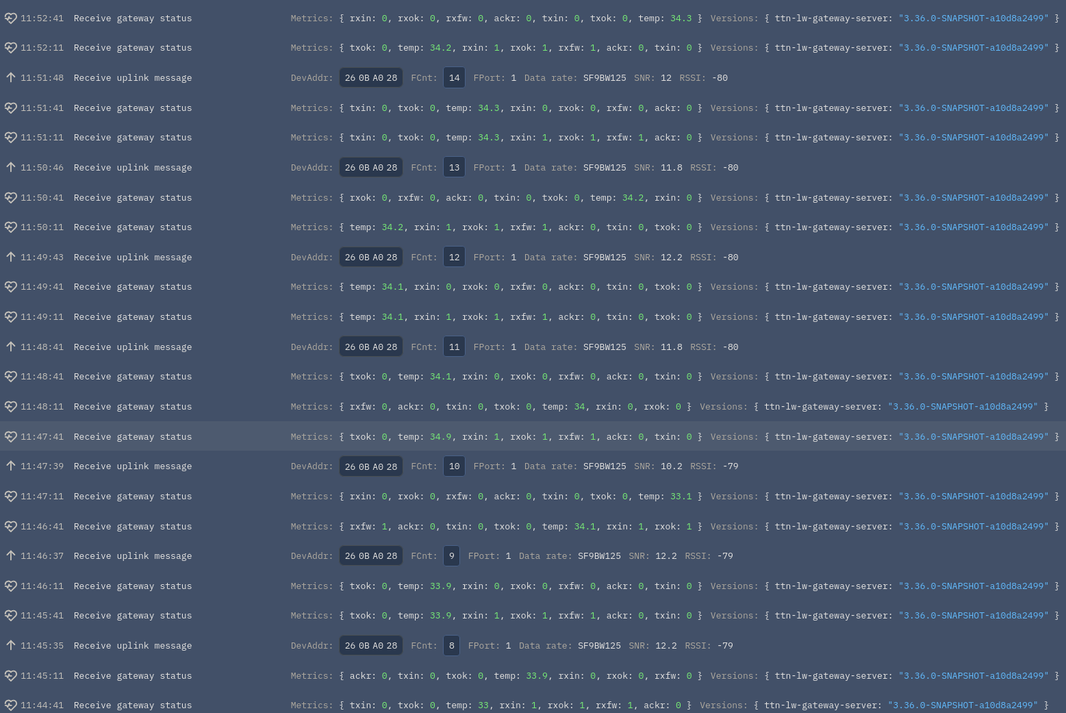

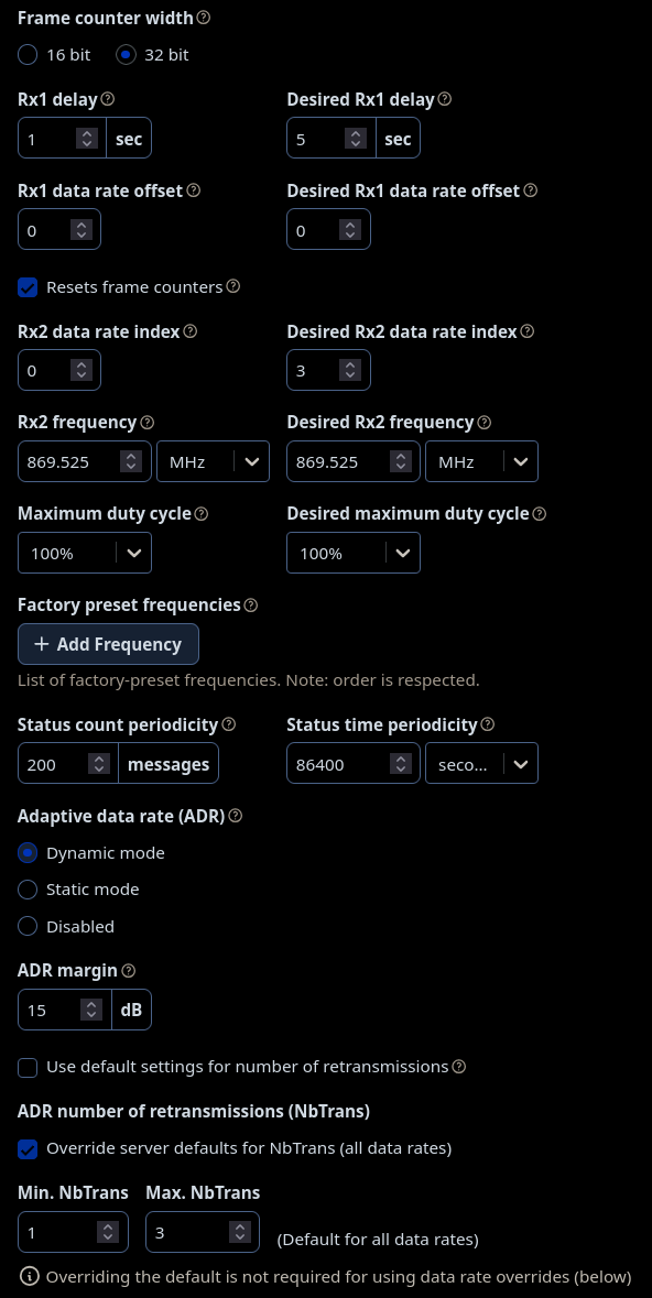

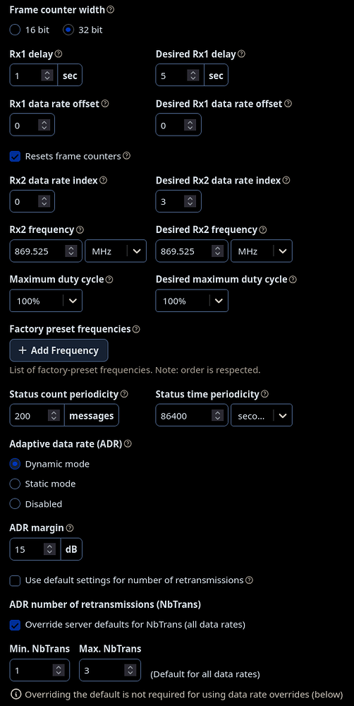

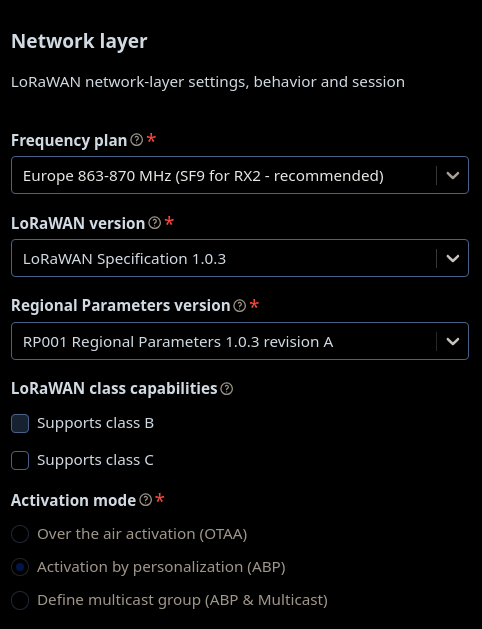

I have problem with not seeing live data for an end device, while reciving data in the gateway. I am using waveshare sx1303 868m lorawan gateway with raspberry pi 4 and as an end device I have ra-01h ai thinker connected to stm32l151c8t6a. I am using LMIC library, but removed the arduino part. In the pictures are shown settings I am using for the end device.

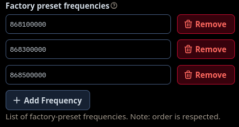

devaddr, nwkskey and appskey all match, but just to be sure i have tried both big endian and little endian forms. i have also tried adding factory preset frequencies. I cant make my application belive that my physical end device and registered end device are the same. Both end device and application live datas are empty.
as much as I understand, if Im using device with my code, the frequency I specify should be used for transmit. if so in lmic_project_config.h i used #define CFG_eu868 1, so i should be using 868.1, 868.3 and 868.5MHz. for those i tried:

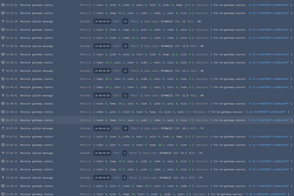

Check the gateway log in TTN console to see if the actual transmissions use those frequencies. Keep in mind also that for ABP you will need to reset the frame counter at TTN when you reset the device. (Otherwise replay attack protection will drop any uplinks for which fcntl is smaller then the highest received in previous sessions)
