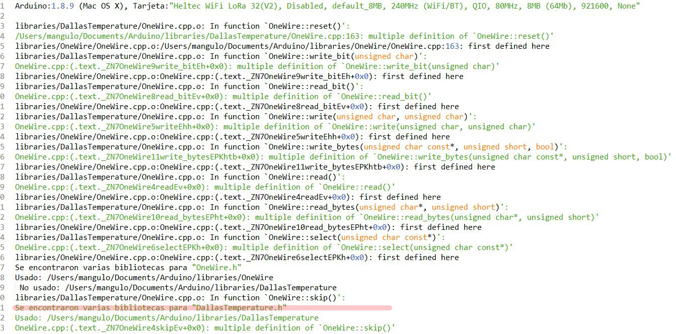

I have a board ttgo esp32 oled lora v2.0.
the board assigned in Arduino board => HELTEC WIFI LORA 32
I get execute code following:
But I get the error following:
Arduino:1.8.9 (Mac OS X), Tarjeta:"Heltec WiFi LoRa 32(V2), Disabled, default_8MB, 240MHz (WiFi/BT), QIO, 80MHz, 8MB (64Mb), 921600, None"
libraries/DallasTemperature/OneWire.cpp.o: In function `OneWire::reset()':
/Users/mangulo/Documents/Arduino/libraries/DallasTemperature/OneWire.cpp:163: multiple definition of `OneWire::reset()'
libraries/OneWire/OneWire.cpp.o:/Users/mangulo/Documents/Arduino/libraries/OneWire/OneWire.cpp:163: first defined here
libraries/DallasTemperature/OneWire.cpp.o: In function `OneWire::write_bit(unsigned char)':
OneWire.cpp:(.text._ZN7OneWire9write_bitEh+0x0): multiple definition of `OneWire::write_bit(unsigned char)'
libraries/OneWire/OneWire.cpp.o:OneWire.cpp:(.text._ZN7OneWire9write_bitEh+0x0): first defined here
libraries/DallasTemperature/OneWire.cpp.o: In function `OneWire::read_bit()':
OneWire.cpp:(.text._ZN7OneWire8read_bitEv+0x0): multiple definition of `OneWire::read_bit()'
libraries/OneWire/OneWire.cpp.o:OneWire.cpp:(.text._ZN7OneWire8read_bitEv+0x0): first defined here
libraries/DallasTemperature/OneWire.cpp.o: In function `OneWire::write(unsigned char, unsigned char)':
OneWire.cpp:(.text._ZN7OneWire5writeEhh+0x0): multiple definition of `OneWire::write(unsigned char, unsigned char)'
libraries/OneWire/OneWire.cpp.o:OneWire.cpp:(.text._ZN7OneWire5writeEhh+0x0): first defined here
libraries/DallasTemperature/OneWire.cpp.o: In function `OneWire::write_bytes(unsigned char const*, unsigned short, bool)':
OneWire.cpp:(.text._ZN7OneWire11write_bytesEPKhtb+0x0): multiple definition of `OneWire::write_bytes(unsigned char const*, unsigned short, bool)'
libraries/OneWire/OneWire.cpp.o:OneWire.cpp:(.text._ZN7OneWire11write_bytesEPKhtb+0x0): first defined here
libraries/DallasTemperature/OneWire.cpp.o: In function `OneWire::read()':
OneWire.cpp:(.text._ZN7OneWire4readEv+0x0): multiple definition of `OneWire::read()'
libraries/OneWire/OneWire.cpp.o:OneWire.cpp:(.text._ZN7OneWire4readEv+0x0): first defined here
libraries/DallasTemperature/OneWire.cpp.o: In function `OneWire::read_bytes(unsigned char*, unsigned short)':
OneWire.cpp:(.text._ZN7OneWire10read_bytesEPht+0x0): multiple definition of `OneWire::read_bytes(unsigned char*, unsigned short)'
libraries/OneWire/OneWire.cpp.o:OneWire.cpp:(.text._ZN7OneWire10read_bytesEPht+0x0): first defined here
libraries/DallasTemperature/OneWire.cpp.o: In function `OneWire::select(unsigned char const*)':
OneWire.cpp:(.text._ZN7OneWire6selectEPKh+0x0): multiple definition of `OneWire::select(unsigned char const*)'
libraries/OneWire/OneWire.cpp.o:OneWire.cpp:(.text._ZN7OneWire6selectEPKh+0x0): first defined here
Se encontraron varias bibliotecas para "OneWire.h"
Usado: /Users/mangulo/Documents/Arduino/libraries/OneWire
 No usado: /Users/mangulo/Documents/Arduino/libraries/DallasTemperature
libraries/DallasTemperature/OneWire.cpp.o: In function `OneWire::skip()':
Se encontraron varias bibliotecas para "DallasTemperature.h"
Usado: /Users/mangulo/Documents/Arduino/libraries/DallasTemperature
OneWire.cpp:(.text._ZN7OneWire4skipEv+0x0): multiple definition of `OneWire::skip()'
 No usado: /Users/mangulo/Documents/Arduino/libraries/Arduino-Temperature-Control-Library-master
libraries/OneWire/OneWire.cpp.o:OneWire.cpp:(.text._ZN7OneWire4skipEv+0x0): first defined here
libraries/DallasTemperature/OneWire.cpp.o: In function `OneWire::depower()':
OneWire.cpp:(.text._ZN7OneWire7depowerEv+0x0): multiple definition of `OneWire::depower()'
libraries/OneWire/OneWire.cpp.o:OneWire.cpp:(.text._ZN7OneWire7depowerEv+0x0): first defined here
libraries/DallasTemperature/OneWire.cpp.o: In function `OneWire::reset_search()':
OneWire.cpp:(.text._ZN7OneWire12reset_searchEv+0x0): multiple definition of `OneWire::reset_search()'
libraries/OneWire/OneWire.cpp.o:OneWire.cpp:(.text._ZN7OneWire12reset_searchEv+0x0): first defined here
libraries/DallasTemperature/OneWire.cpp.o: In function `OneWire::OneWire(unsigned char)':
OneWire.cpp:(.text._ZN7OneWireC2Eh+0x0): multiple definition of `OneWire::OneWire(unsigned char)'
libraries/OneWire/OneWire.cpp.o:OneWire.cpp:(.text._ZN7OneWireC2Eh+0x0): first defined here
libraries/DallasTemperature/OneWire.cpp.o: In function `OneWire::target_search(unsigned char)':
OneWire.cpp:(.text._ZN7OneWire13target_searchEh+0x0): multiple definition of `OneWire::target_search(unsigned char)'
libraries/OneWire/OneWire.cpp.o:OneWire.cpp:(.text._ZN7OneWire13target_searchEh+0x0): first defined here
libraries/DallasTemperature/OneWire.cpp.o: In function `OneWire::search(unsigned char*, bool)':
OneWire.cpp:(.text._ZN7OneWire6searchEPhb+0x0): multiple definition of `OneWire::search(unsigned char*, bool)'
libraries/OneWire/OneWire.cpp.o:OneWire.cpp:(.text._ZN7OneWire6searchEPhb+0x0): first defined here
libraries/DallasTemperature/OneWire.cpp.o: In function `OneWire::crc8(unsigned char const*, unsigned char)':
OneWire.cpp:(.text._ZN7OneWire4crc8EPKhh+0x0): multiple definition of `OneWire::crc8(unsigned char const*, unsigned char)'
libraries/OneWire/OneWire.cpp.o:OneWire.cpp:(.text._ZN7OneWire4crc8EPKhh+0x0): first defined here
libraries/DallasTemperature/OneWire.cpp.o: In function `OneWire::crc16(unsigned char const*, unsigned short, unsigned short)':
OneWire.cpp:(.text._ZN7OneWire5crc16EPKhtt+0x0): multiple definition of `OneWire::crc16(unsigned char const*, unsigned short, unsigned short)'
libraries/OneWire/OneWire.cpp.o:OneWire.cpp:(.text._ZN7OneWire5crc16EPKhtt+0x0): first defined here
libraries/DallasTemperature/OneWire.cpp.o: In function `OneWire::check_crc16(unsigned char const*, unsigned short, unsigned char const*, unsigned short)':
OneWire.cpp:(.text._ZN7OneWire11check_crc16EPKhtS1_t+0x0): multiple definition of `OneWire::check_crc16(unsigned char const*, unsigned short, unsigned char const*, unsigned short)'
libraries/OneWire/OneWire.cpp.o:OneWire.cpp:(.text._ZN7OneWire11check_crc16EPKhtS1_t+0x0): first defined here
collect2: error: ld returned 1 exit status
exit status 1
Error compilando para la tarjeta Heltec WiFi LoRa 32(V2).
/Users/mangulo/Desktop/DS18b20 sensor lora/lora_ds18b20/lora_ds18b20.ino
Este informe podría contener más información con
"Mostrar salida detallada durante la compilación"
opción habilitada en Archivo -> Preferencias.
variaslibs

ok but it could be that he has some library’s more then one time (see red marker) and confusing his compiler

I try examples dallastemperature but I get same error. I have some wire wrong sure. Thanks
you have double libraries… (se encontraron VARIAS bibliotecas)
make sure there is only one temperature library
