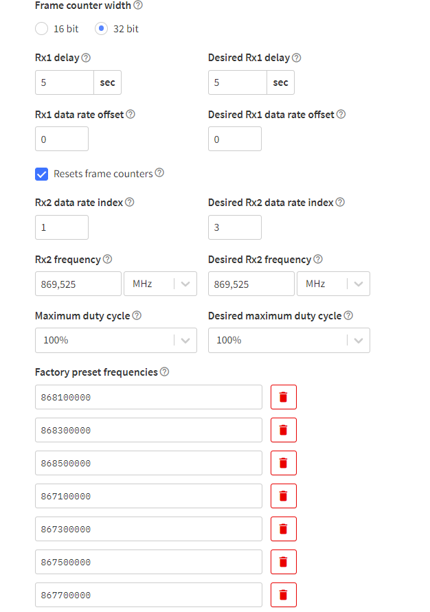

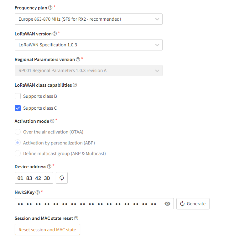

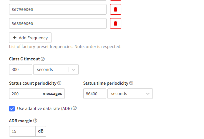

- The uplinks are received by the application correctly, but suddenly, the messages continue to arrive at the gateway but not at the application.This is the configuration of the device:
