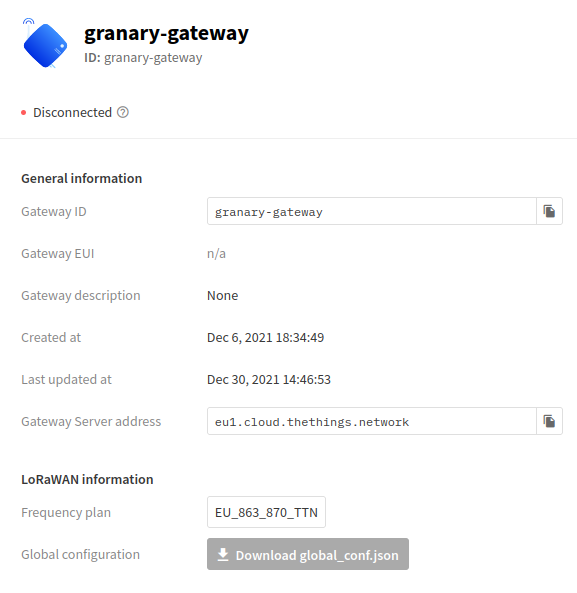

Really sorry, but I can't get my gateway to connect on V3 either
Hi all, I am finally getting some time to sort out my gateway and nodes which were all working well on V2 up until the start of December of course. Not urgent, its just a hobby setup.
I followed the guides to transfer my nodes (only around 3 or 4), but can’t tell if I’ve done that correctly until I get my gateway connecting to V3. There are no other gateways covering my area.
My gateway consists of an n-fuse mpcie concentrator board mounted in a USB adaptor connected to an old PC running Ubuntu Server 20.04. It has a small 3~5dB antenna mounted on the outside of the PC case but still indoors.
Here is my gateway in the console:
Screenshot from 2021-12-30 15-54-30
More to follow in next post.

A common problem (search the forum for details). This should be the exact same as whatever you have in the Gateway EUI because as the information travels down the wire, the Internet Goddesses translate gateway_ID in to gateway_EUI without mercy or prior notice.
On the console the Gateway ID is an identifier for the users use, which could be “PaulRB2-is-cool” ie it has no bearing on the functionality.
This should be a 16 ‘digit’ hex number, the gateway EUI, not a random name.
@descartes @kersing Thanks very much! It’s now connecting and reporting received rf packets :+1:
Yes, the gateway_ID field on the gateway settings in the console not corresponding to the gateway_ID field in the global_conf.json fooled me! Naturally I felt sure they should match.
For others with a similar issue, this is what you need to do:
You need to get your EUI from your concentrator. In my case, its not printed on the label, I had to find a utility to run that prints it out:
sudo ~/loragateway/picoGW_hal/util_chip_id/util_chip_id
(You may need to amend that to match the folder where you installed the software on your machine.)
The above just spits out the 16-digit number. In my case, by chance, it consisted only of digits 0-9, no A-F digits to make it obvious it was in hex.
I then stopped the packet forward service, edited global_conf.json and changed the “gateway_ID” to the EUI. Then edited the general settings in the TTN console to update the EUI there. Started up the packet forward service again and bingo.
