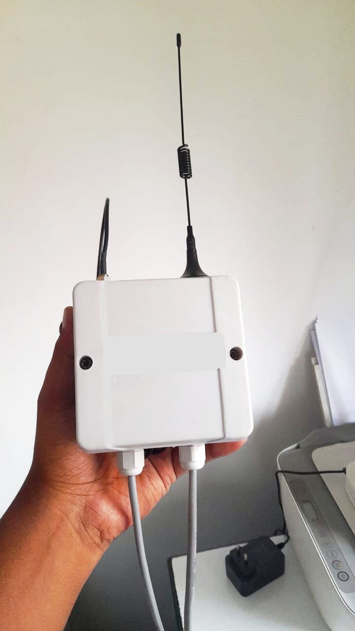

I have developed a single-channel LoRaWAN gateway, and it is covering almost 3 KM
Single Channel Packet Forwards are not at all welcome on TTN as they represent a denial of service attack on the local network.
