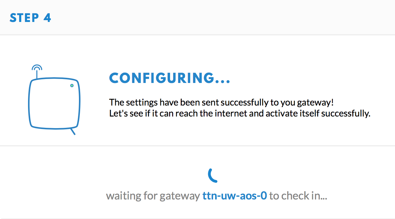

I’ve been trying to go through the process of getting our new Things Gateway online and have hit a brick wall. Registration was successful. Configuration was successful. But the process then hangs on Step 3 “Waiting for the gateway to check in”. We’ve tried this both with WiFi and Ethernet connections, and we tried the WiFI through two different routers – the building’s and my phone’s mobile hotspot. In all cases, the lights on the gateway indicate that it’s trying to activate but failing, then it resets itself and cycles through the previous modes. Interestingly, we were able to obtain the IP address of the Gateway on the ethernet connection and connect to it from a laptop, but it still is unable to ‘activate’.

Attached is a screen grab showing where the activation process hangs.
