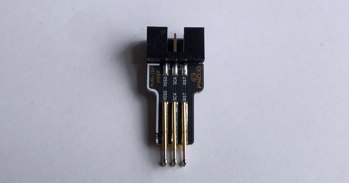

put one with a pogo pin to the required connection
yes that’s the 'plan

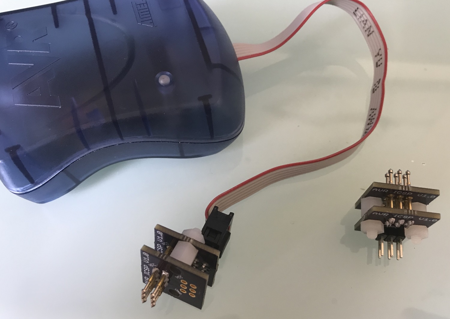

Which programmer do you have ?
I was thinking using a 3v3 arduino mini pro
Yes it’s do able of course, but programming fuse and other always a headache like that because all are in config boards files and you don’t really see if all went fine.
My 2 cents, and what I’ve done, buy a real AVRISP MKII (no more manufactured) programmer and flash with Atmel Studio as described here https://github.com/hallard/Pro-Mini-ICSP-FTDI
Note to low down 5V output to 3.3V to avoid burning RFM95 during flash process
I was able with low cost chineese programmer after again headache burning another firmware to get them working with arduino IDE flash.
This one should works
thank you Charles… I will first study all this before burning anything
something like that may help also
Or build your own like I done
