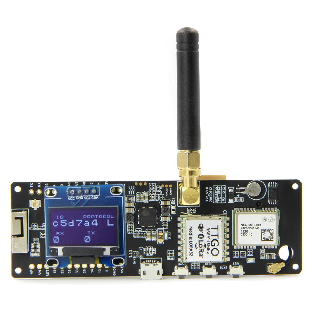

Seems to be a new version out (ordering one as my old one has failed anyway) T22_V10 20190612
Product Upgrade Content
1. Pin GPIO34 pin is replaced with GPIO35
2. Replace the charging IC (TP5400) with the power management AXP192
3.GPS TX, RX pin replacement
4. Power on and remove, replace with button to open
5. Reduced sleep current
6.GPS battery replacement
Some more info > https://github.com/Xinyuan-LilyGO/TTGO-T-Beam
