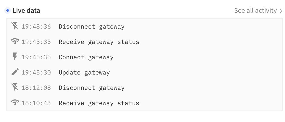

Understood, its plugged back in now. Seems to be the same LED behavior as before.
I doubt anyone’s fixed anything because they need to read the logs first …
its solid green now! any chance of knowing what changed?
No changes on the server. I checked the logs on the server
  • Your gateway initiated CUPS connections at 15:37, 16:15, 16:45 and 16:58 (CET)
  • In each case the server responded with an LNS configuration asking your gateway to connect to the nam1 gateway server.
LBS connections are kept alive via Websocket ping pong. Your gateway isn’t responding to server pings.

This does very much sound like a network issue. Tomorrow, I’ll try to check if there’s network latency or something that’s causing this. My current prognosis is that there isn’t anything wrong on the server side.
LOL
They’ve definitely turned it off & on again, so I guess the next one is the venerable ā€œit’s working for meā€!!
It is working for me - the TTN one, the TTI Discovery one and the totally illegal one setup for US915 in the lounge whilst I occasionally test stuff.
@KrishnaIyerEaswaran2, why not turn it off at your end and we can check how many notice. Then turn it back on again to see what still works!
I also did a full clean reclaim of a couple of test gateways and I have no issues connecting with the nam1 cluster. I don’t see any issues on the server side either.
I would recommend trying a different network (maybe 4G), check if port 8887 is blocked by your ISP or in the worst case return your gateway to the vendor so that they can run tests to see if there’s a hardware issue.

Did not work in what way - did you see an error message in the console? Perhaps relating to GW ID already having been used or similar?
What does TTN tell you has happened/is happening?
You’ve done the home work, gathered the data, formatted the logs, just the stuff every tech forum asks for, so no need to be scared. It’s those that post one liners that lead to 20 questions that they answer tangentially or not at all that end up with the volunteers getting frustrated.
BTW, most of us don’t crack open our TTIGs so the log is a bit of niche knowledge!
It appears that the date & time aren’t getting updated on the TTIG which means the security certificates will be invalid. Forum search (for the win) indicates this is a situation that has occurred in that past with some routers. Can you try the TTIG with another router or tether to your mobile to get it online & allow any firmware updates. If that shows it working, we can then figure out if the Zyxel is the issue.
[Note to self, crack open TTIG, put on UART, enjoy the datas!]
Which firmware version does your TTIGs have? Did you checked it?
In the Console, all seems ok, it just say ā€œDisconnectedā€.
The good TTIG lives on the same router, and both of them has worked for a long time.
I swapped the radio module between the good and the bad one, and the radio hw is ok.
Is seemes to me that something has heppend to the config system.
In the start of the log, I see the bad one try to connect to ā€œhttps://rjs.sm.tc:9191ā€.
And it goes i a loop and try doing something to ā€œhttps://rjs.sm.tc:9191ā€.
The good one do the same to ā€œhttps://eu1.cloud.thethings.network:443ā€, and it gets what it want.
But I see no way or tools I can use to change this behavier for the ā€œbad oneā€.
And ofcorse I do not deear to reset the good one, who knows what wil happen, I guess this will also start connecting ā€œhttps://rjs.sm.tc:9191ā€ to get certicicat or other configurations.
