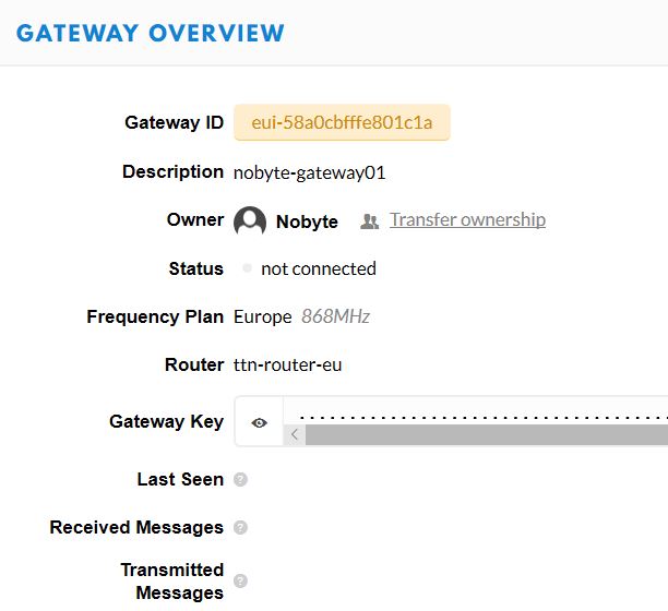

Today I installed my first TTIG but I get a “not connected” status when I look at the console. I have checked the Getaway_ID several times and can not find a mistake. However, the green light on the TTIG is constantly on, so it shows it is connected, but not in the console? The ID is eui-58a0cbfffe801c1a, when I try http://noc.thethingsnetwork.org:8085/api/v2/gateways/eui-58a0cbfffe801c1a I get:
{“error”:“status not found”,“message”:“status not found”,“code”:5}
Can anybody help? Thank you very much in advance!

I have taken a photo of the TTIG label and a screenshot of the console:
The Status in the console is still “not connected” this is so frustrating. However I tried to contact #ops at Slacks, Maybe someone from TTN can help. Thank you for your hints!

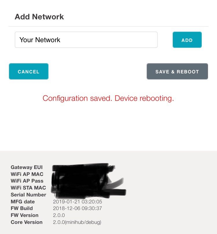

Nobyte,
please also once check the page in the setup mode if you push your Wifi setting to it.
The TTIG is auto config from a server somewhere on the internet. And will use the hard programmed Gateway EUI (ID). check this with what you have on your label.
