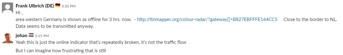

they are NOT offline… data is flowing

Please check EU TTn Server Down? before posting additional “My gateways are not connected as well” messages. There are issues with the console where it does not show the correct status for gateways. Which gateways are reported connected and which aren’t seems random.

htdvisser 2019-11-29 11:30
The EU region of the community network has been struggling with a number of misbehaving UDP gateways the last few days, and especially yesterday. These gateways seem to be pretending to be other gateways by using different gateway EUIs, and are flooding our infrastructure with packets (sometimes hundreds per second), which affects other gateways that are load-balanced to the same server instance (udp bridge).

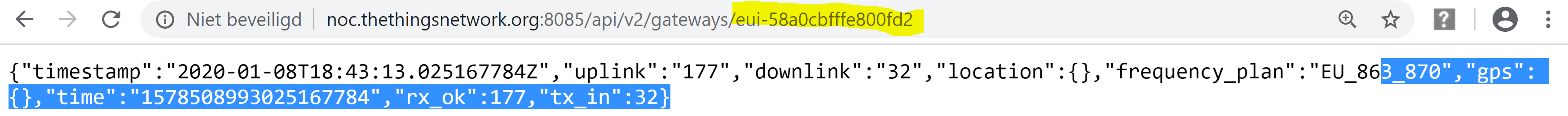

I see your gateway connected to the TTN network
You can see that on "http://noc.thethingsnetwork.org:8085/api/v2/gateways/“gateway-ID”
Maybee time, but your gate way is online.
Johan
The message where you got the ID from was 27 days old. So it seems to be fixed.
I tried my ID:
http://noc.thethingsnetwork.org:8085/api/v2/gateways/eui-58a0cbfffe802080 and get:
{“error”:“status not found”,“message”:“status not found”,“code”:5}
Same result for the ID @keiltronic has posted.
Does it just take a few days? But if so this fact should be documented somewhere.
