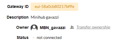

I added my TTIG yesterday. It shows not connect when ever I a have a glance in the console.
The console shows last seen 8 hours ago.
eui-58a0cbfffe801ffa
Any ideas.
