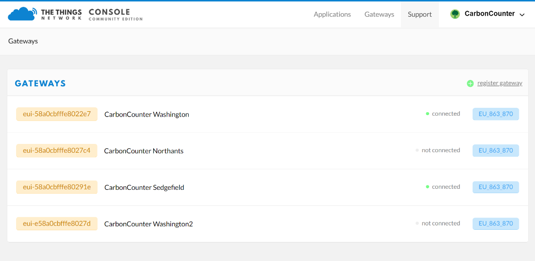

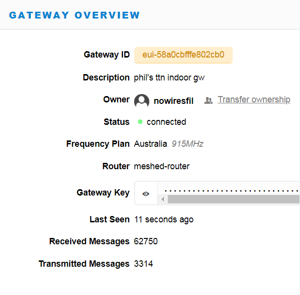

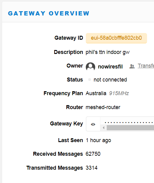

TTIG "not connected"
Did you see the post above yours?
I do. I am really wondering if there is something here that needs more attention than just the TTN console. Is TTN Mapper just pulling its data from TTN Console via the API? Is the problem related to the new protocol used with the Indoor Gateway? Is it the TTN Console? Is there something that I might have missed that I could do to fix this? Please remember that I saw a similar discussion a year ago so I am really trying to see if I missed something at my end. Any help and advice would be welcome. Thanks.
No there is not. There are known issues with gateway state in the console which are not related to the protocol used to connect the gateway to the back-end.
TTN Mapper currently relies on the same data set because querying the status of all known (to TTN Mapper) gateways takes too much time. (Search the forum and you will find messages concerning this.)
You can head over to the TTN slack #ops channel and shout out hoping someone will be able to reset whatever isn’t working right.
Thank you for the suggestion. I posted the request.
Please do not expect a response - it’s been made clear (above and all over other forum posts) that this is not going to be fixed.
Not going to ever be fixed – Or is the expectation that TTN V3 is the fix?
It won’t be broken in v3 but it may be different!
We have a known issue related to our v2 “NOC” service that sometimes shows online gateways as offline. We are not going to fix this issue.
Another known issue is that Basic Station gateways experience websocket timeouts. This is fixed in the new 2.0.4 and 2.0.5 firmware versions that are currently being tested. Maybe @KrishnaIyerEaswaran2 can comment on this.
And as @descartes just wrote: in v3 things will be different.

I have a gateway that is forwarding packet with a status not connected. eui-e58a0cbfffe8027d
http://noc.thethingsnetwork.org:8085/api/v2/gateways/eui-e58a0cbfffe8027d
returns message
{“error”:“status not found”,“message”:“status not found”,“code”:5}
The SSL cert on the checking link has probably expired. I deleted the http(s) and have information from a Gateway that has status not connected.
http://noc.thethingsnetwork.org:8085/api/v2/gateways/eui-58a0cbfffe8027c4 provides information
{“timestamp”:“2020-11-12T06:20:44.929881175Z”,“location”:{},“frequency_plan”:“EU_863_870”,“platform”:“minihub - Firmware 2.0.0 - Protocol 2”,“gps”:{},“time”:“1605162044929881175”}
The failure of gateways correctly register is frustrating as am making R&D with a view to large roll-out of LoRaWAN devices and replacing traditional modem comms in both water data loggers and electric meters.
Is that EUI a typo? There shouldn’t be an ‘e’ in front of the 58. Did you use the right eui while registering?
Definitely a typo.

I have TTIG AU915 and having similar issues.
Have noticed its dashboard status turns to “not connected” after 1 hour of hearing no node uplinks/received messages
If I power cycle, it shows connected for 1hr but then reverts to “not connected”
Other brand gateways I operate, uplink a periodic ‘stats’ message which keeps the connection alive regardless of whether nodes are uplinking. Is this a solution for TTIG?
Cheers,ƒil
