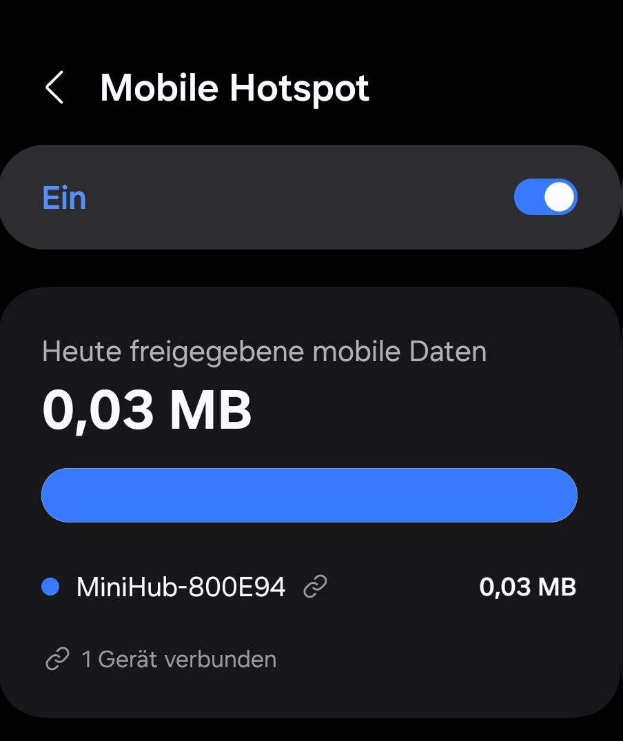

i have the same result on mobile hotspot
he is connecting but the same result on both networks
