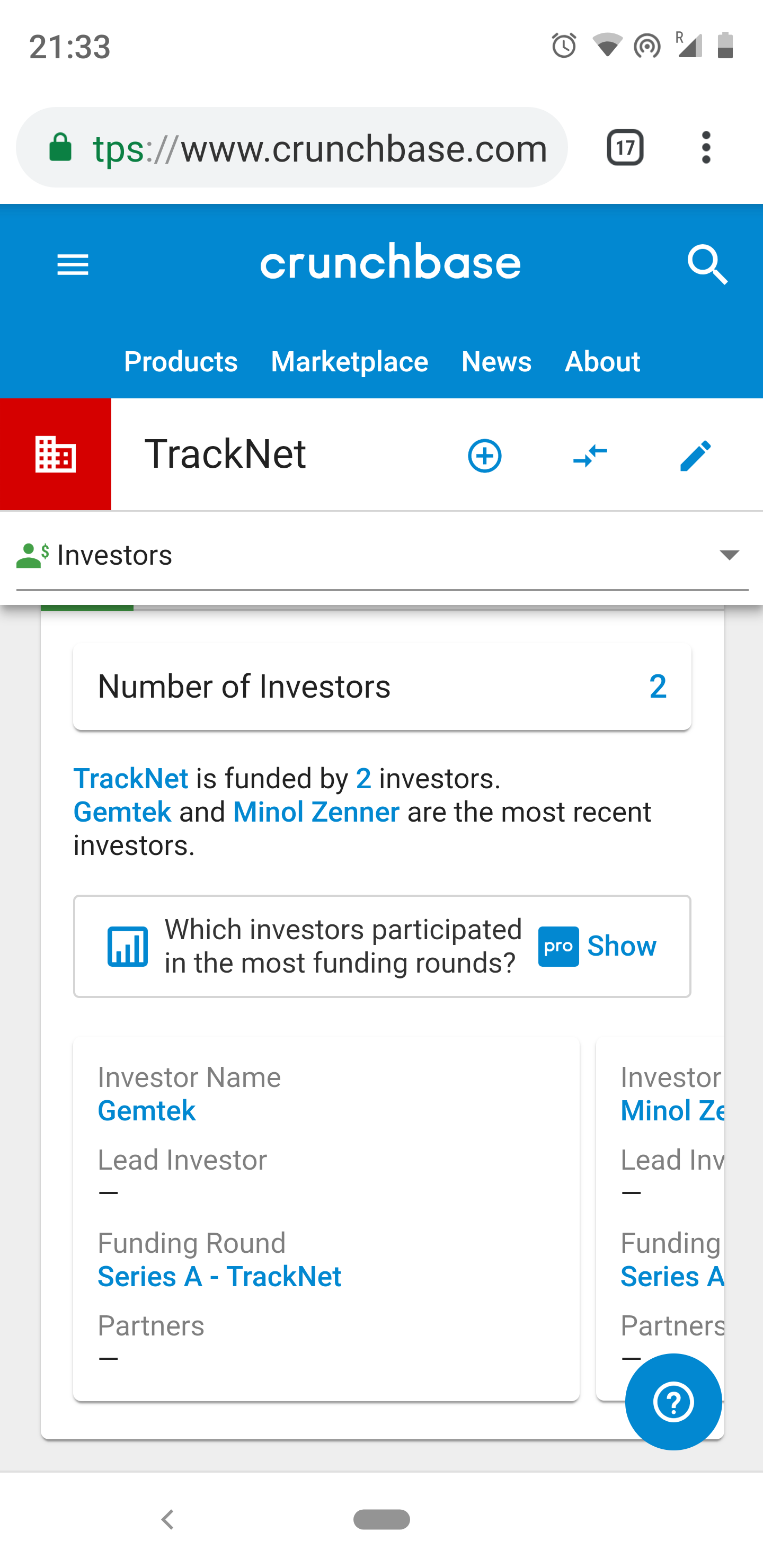

(Verkehrsrot) #56
okay this seems the background: Tabs is Trackio GmbH and main investors are GemTek and Zenner.
Screenshot_20190201-213309

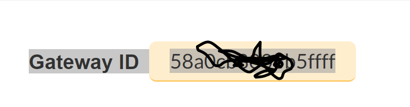

#60
What is the right spelling off the Gateway ID from the mac adress
I tried severall ways with no succes
May allso a screenshot off the device registration
