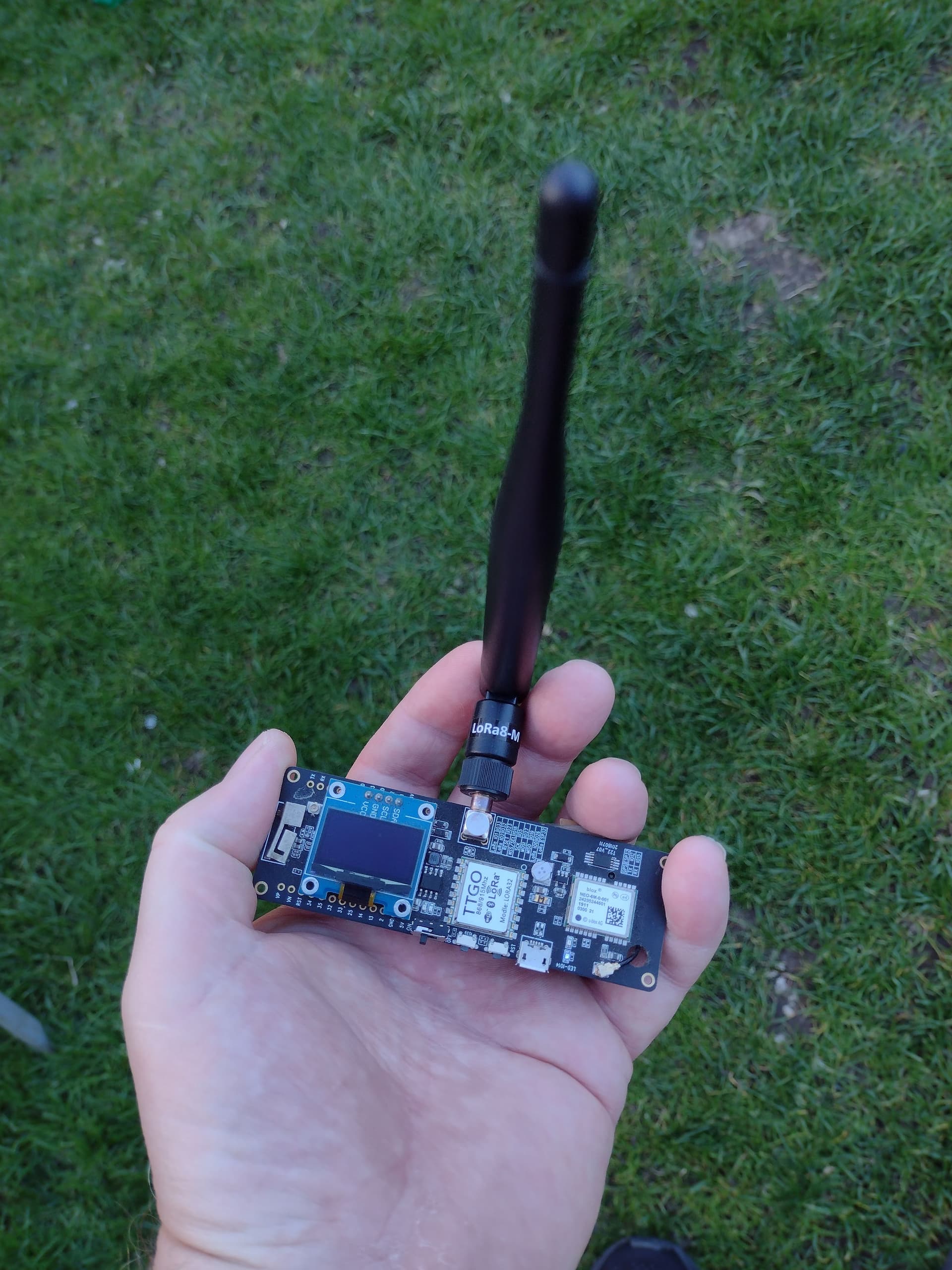

Programmed a ttgo-tbeam-ttn-tracker using a –
to check local station reception on

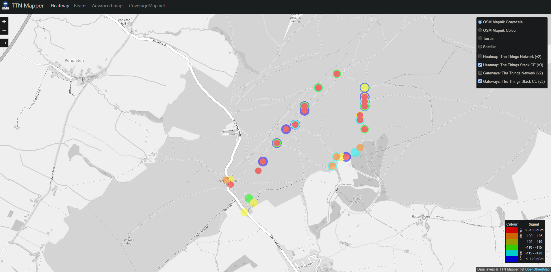

Went for a walk on the local hill and happy with results, I noted multiple stations received the location packet, as indicated via different signal rings at same location on ttnmapper

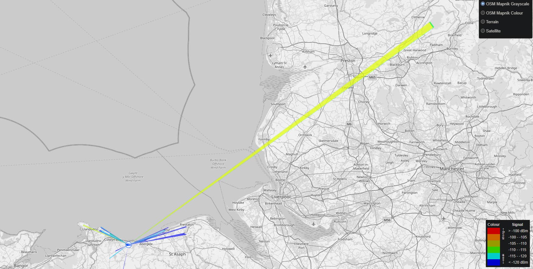

and downloading the .json file for my device I can see several ground stations –
burnley
netbeam-2
gc-ccbc-llysfaen-ysgolcynfran
gc-ccbc-colwynbay-ysgolpenybryn
gc-ccbc-colwynbay-oc-ysgolbrynelian
bidstonlight-iot-balticbroadband
not bad from a 100mW hand held device to stations 60 Miles away
