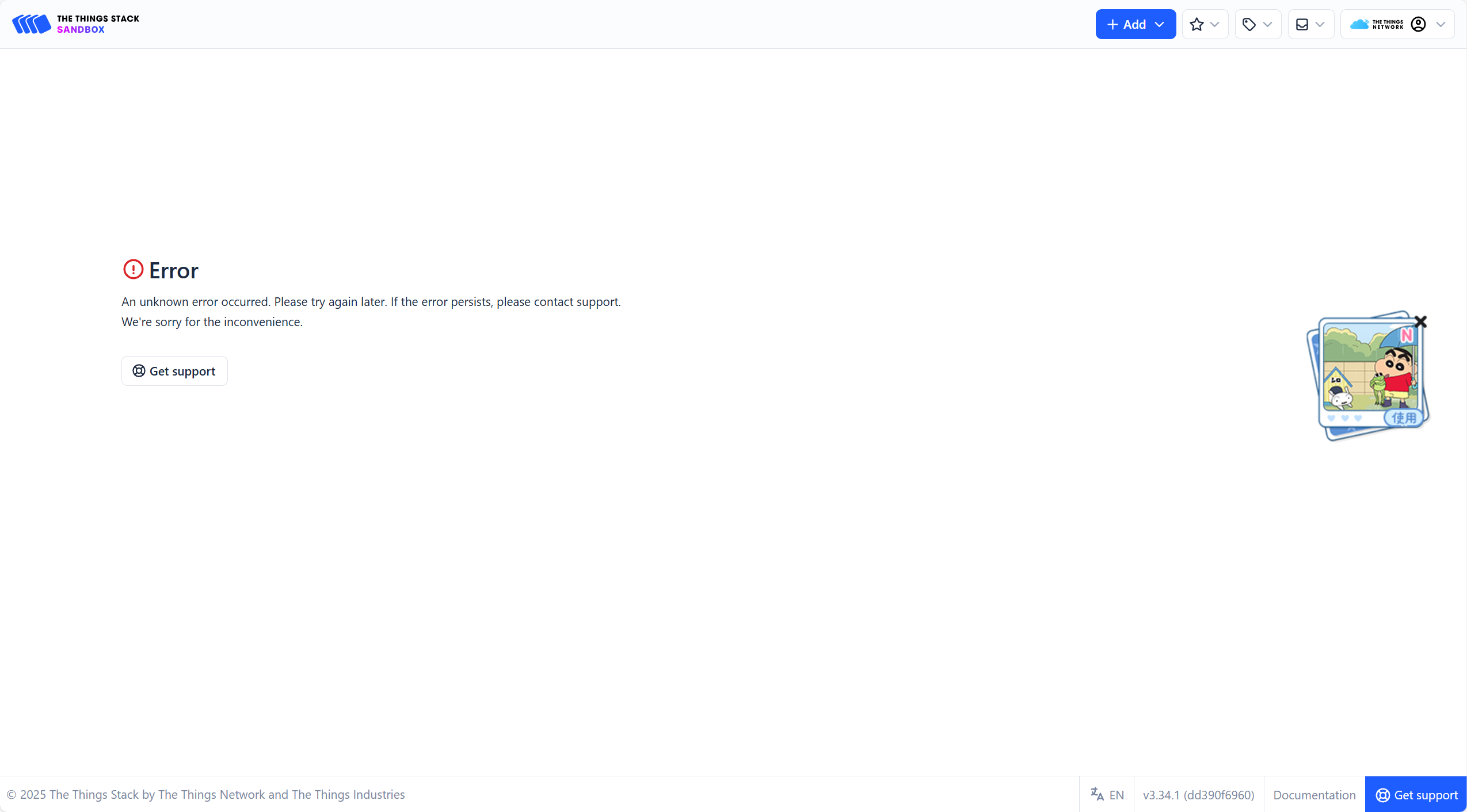

我总是无法注册ttn网关
我无法注册TTN网关,我用我的电脑注册总是出现未知错误,但是我用另一台电脑就能注册,但是注册之后我重新登录打开,仍然不能找到我注册了的网关,我想再次注册时却显示该网关已经注册

What I mean is: I can’t register the TTN gateway. When I try to register it with my computer, there’s always an unknown error. However, I can register it with another computer. But after registration, when I log in again and open it, I still can’t find the registered gateway. When I try to register it again, it shows that the gateway has already been registered.
