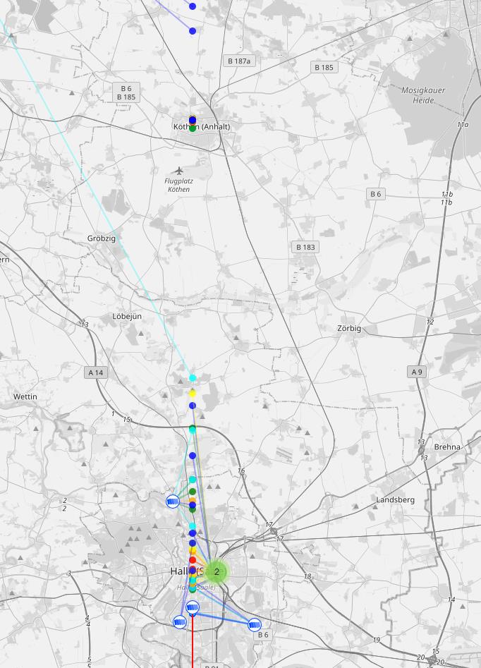

Hello, I have connected my Dragino TrackerD to the ttnmapper and coordinates are also transferred. While the latitude is correct, the longitude value is always the same (it seems to be the location where I registered the node).
The correct coordinates are transmitted in the decoded payload, and the right coordinates are also used in the other connected apps, such as datacake.
Here is a screenshot that illustrates the problem.
ttnmapper issue latitude
What could be the reason for this?
Hello,
I have found the cause of the problem. In the payload formatter of the Dragio TrackerD was “Longitud” instead of “Longitude”. Elsewhere in the payload there is a static coordinate for the location (not very useful for a moving node (?)), there is also “Longitude”, obviously the ttnmapper used this value. After I replaced “Longitud” with “Longitude” in the payload formatter, it works.
