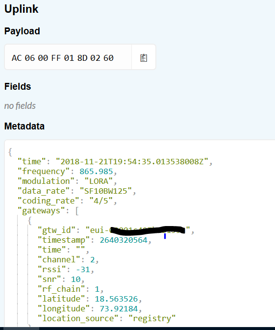

Unable to get data in right format for AcSIP S76SXB
Please see the data… I m using AcSIP S76SXB -Nothing in Field .So it is not usable for TTN Mapper and Cayenne Dashboard.
Payload is there. Did you add a decoder it in the Applications/Payload Formats section?

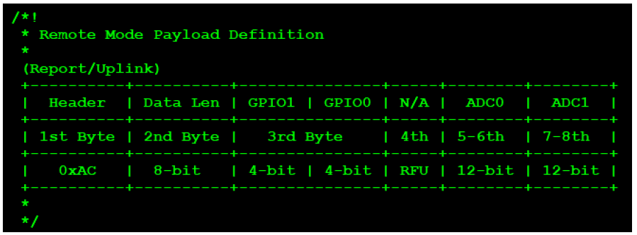

As per AcSIP S76S doc…the data structure is as follows:
Sorry, I don’t see any reference to coordinates there, and it surely does not match your decoder function. Like the 1st byte (being byte[0] in the JavaScript decoder function) has a fixed value, and the 4th byte (being byte[3]) is marked as “reserved for future use”, while your decoder is using both.

The format you show could possibly be decoded using:
  var header = bytes[0];
  if (header !== 0xAC) {
    return {
      error: 'Unsupported payload header'
  var len = bytes[1];
  if (len !== 6) {
    return {
      error: 'Unsupported payload length'
  var gpio0 = bytes[2] & 0x0F;
  var gpio1 = bytes[2] >> 4;
  var rfu = bytes[3];
  // Documented as 12 bits; assuming MSB and not supporting negative values
  var adc0 = bytes[4]<<8 | bytes[5];
  var adc1 = bytes[6]<<8 | bytes[7];
  return {
    gpio0: gpio0,
    gpio1: gpio1,
    adc0: adc0,
    adc1: adc1

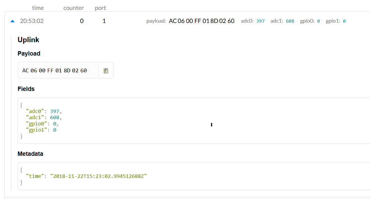

(Please, don’t post screenshots for terminal output.)
For payload AC0600FF018D0260 it shows following outcome
“adc0”: 397,
“adc1”: 608,
“gpio0”: 0,
“gpio1”: 0

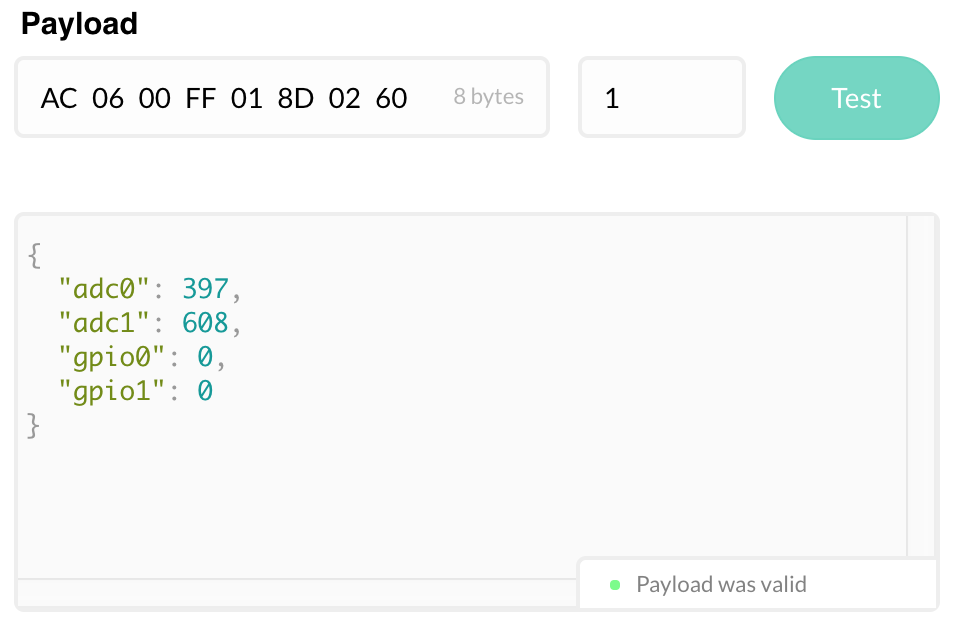

To answer my own question: you used a decoder that you found in a topic about a different device, the TTGO T-Beam.
True, and very much as expected. And, you’ll get the very same result when using that payload to test the decoder function:

Thanks for support. Since I can see the RSSI, SNR and Location in Payload, I want to extract the same also and want to integrate the data with Cayenne Dashboard !!
If the payload structure is the one you mentioned above, there is no location. The location you see is the gateway location.
EDIT: and since the gateway will be fixed in some place, there is no need to track it :wink:
This is node data capturing RSSI, SNR and location:
Right now Node is next to Gateway so it will show almost same coordinates.
Like explained above, given that structure, there is no location data in your node’s payload. Does it even have a GPS module? And the metadata of the gateway(s) is not giving you your node’s location either.
Posting the same image again is not helping. Instead: what is your exact question? What are you trying to show with the above screenshot?
No: this is gateway data capturing RSSI, SNR of the received packet and its own location. Node does not know about RSSI and SNR (and in your case, about location too).
And even more: if your node’s transmission is received by multiple gateways, you’ll get coordinates of multiple gateways as well. And those could be many kilometers apart.
(You might think you can then calculate the node’s position, but: no. See Location by triangulation for that.)
If you want to access the gateway(s) metadata in a payload format Decoder function: that is not possible. You’ll only get those details using some integration, or by using the MQTT data API.
