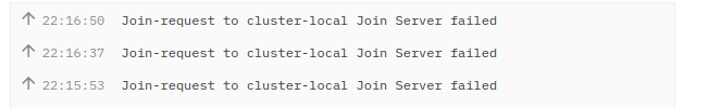

Looking at the gateway logs and the node logs I can see the join requests show up:
The messages in the node console are due to “MIC mismatch”

Not clear if this means more MIC mismatches or some other failure mode, if you could clarify then I may be able to find some other people with other perspectives on this.
I get MIC mismatch messages in the console and the same Rx 2 timeout messages as before from serial output.
The MIC mismatch means the payload wasn’t able to be verified so no Join Accept is issued so nothing for the device to hear as a request.
